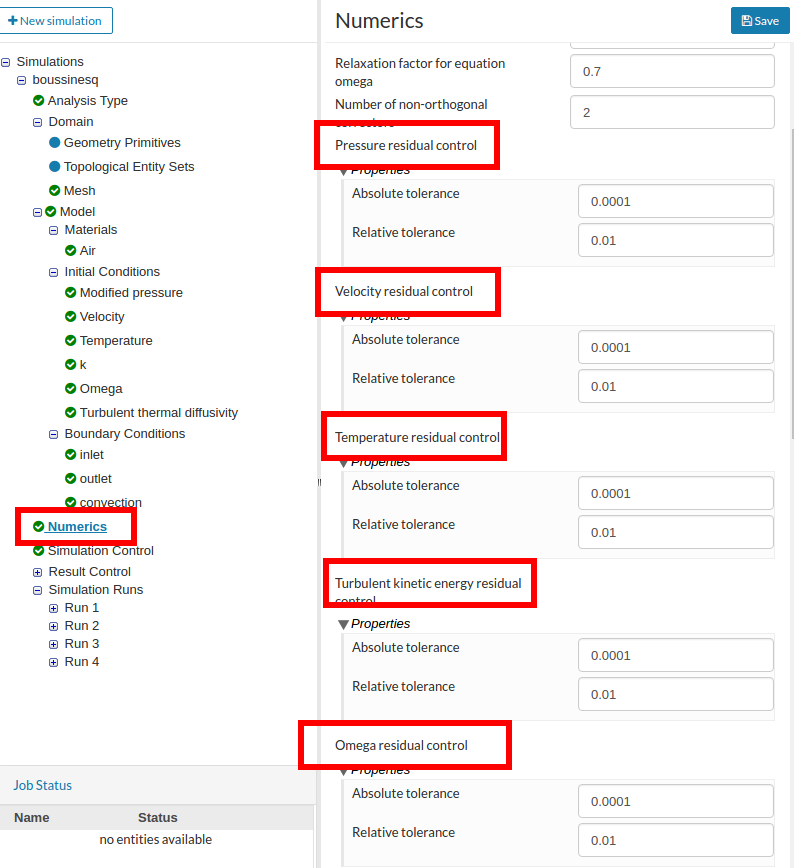

Hi I have noticed that some of my simulations are ending early.
example: I set 1000 as an end time, time step 1. and 1000 write interval but the simulation
ends at time 300. I still get the results ok.
Is this because it has converged and does not need to go any further?
Hi @gcanfield,
exactly - you can set prior to the simulation run when you consider the simulation to be “converged” via the residual control settings under Numerics (see screenshot). When all residuals have dropped below the specified threshold, the simulation is stopped and the last results written.
David
Excellent Thank you
So if I see during a simulation that it has converged as much as its going to can I stop the simulation for the results as there’s no point in it continuing?
Hi @gcanfield,
so if you stop the run, it will also write out the last time step if that’s what you mean.
David
Hi David
Thanks I have tried this but I do not think it writes the last time step as when I try to post process it in paraview
it will not go to the last step. still not a problem though I will just not cancel.
Thanks again
