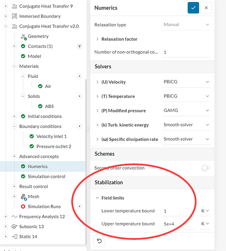

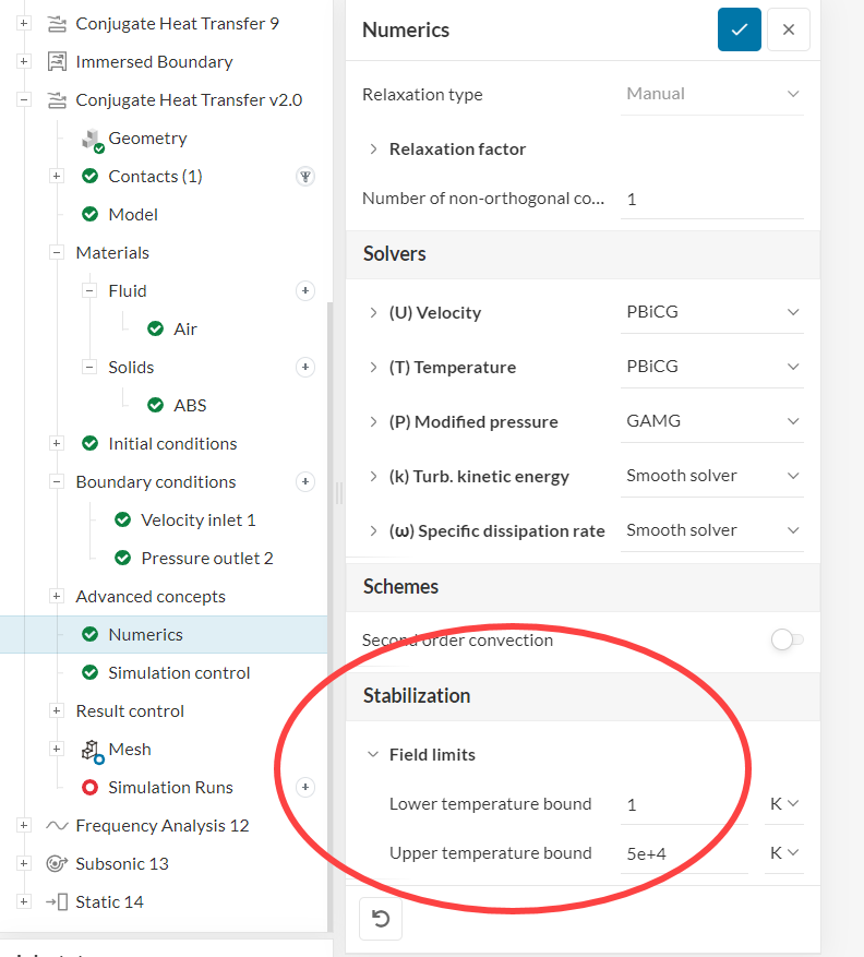

Hi!
From the description, it sounds like some parts are losing excessive amounts of heat due to a given heat transfer mechanism (e.g. maybe due to radiation and a combination of relaxation factors), which can cause some parts to artificially reach unphysical levels of temperature.
One way to go about it is by applying field limits for temperature and simply preventing temperatures lower than the inlet (or whatever else makes sense) in the domain.
Alternatively, playing with relaxation factors and/or ramping the temperatures can help.
