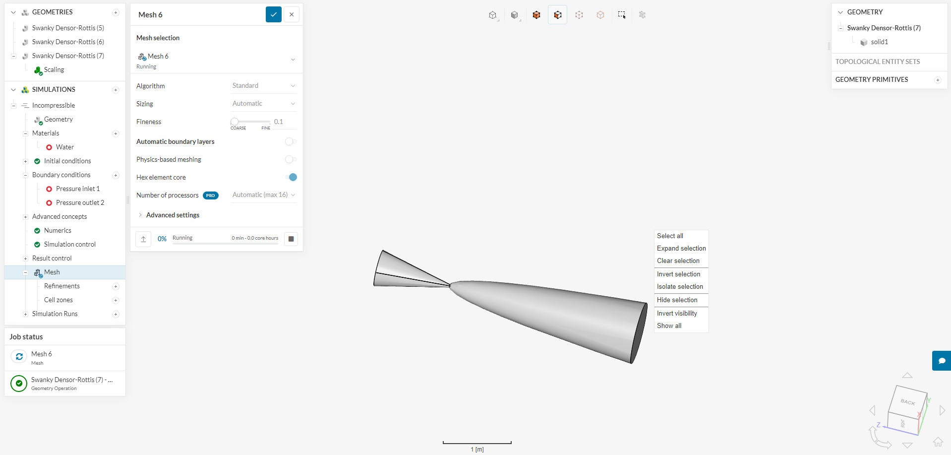

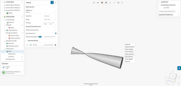

My mesh has been at 70% for 2 hrs
there is nothing I can do plz help
Hey there!
I suggest you to let the computation finish or fail by its own. Probably the resulting mesh will be too large to be used for your simulation, so probably you will need to change the parameters to receive a coarser mesh. You can even to that in parallel, while the other one finishes.
good idea, I will check size
it said 100 meters… I am shrinking it
it should only be 1 meter
let’s see if this works
tried again with different algo, worked
