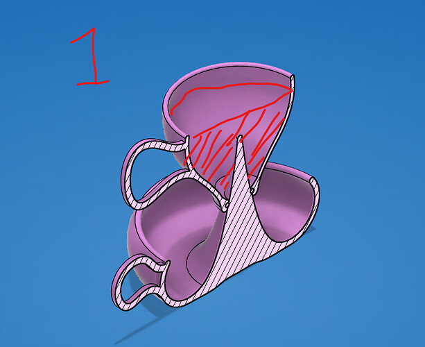

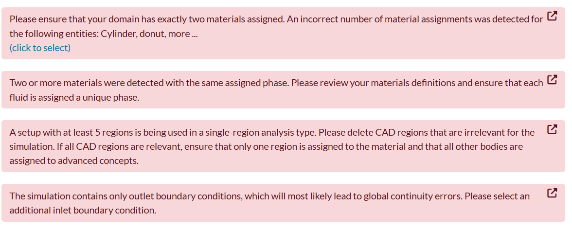

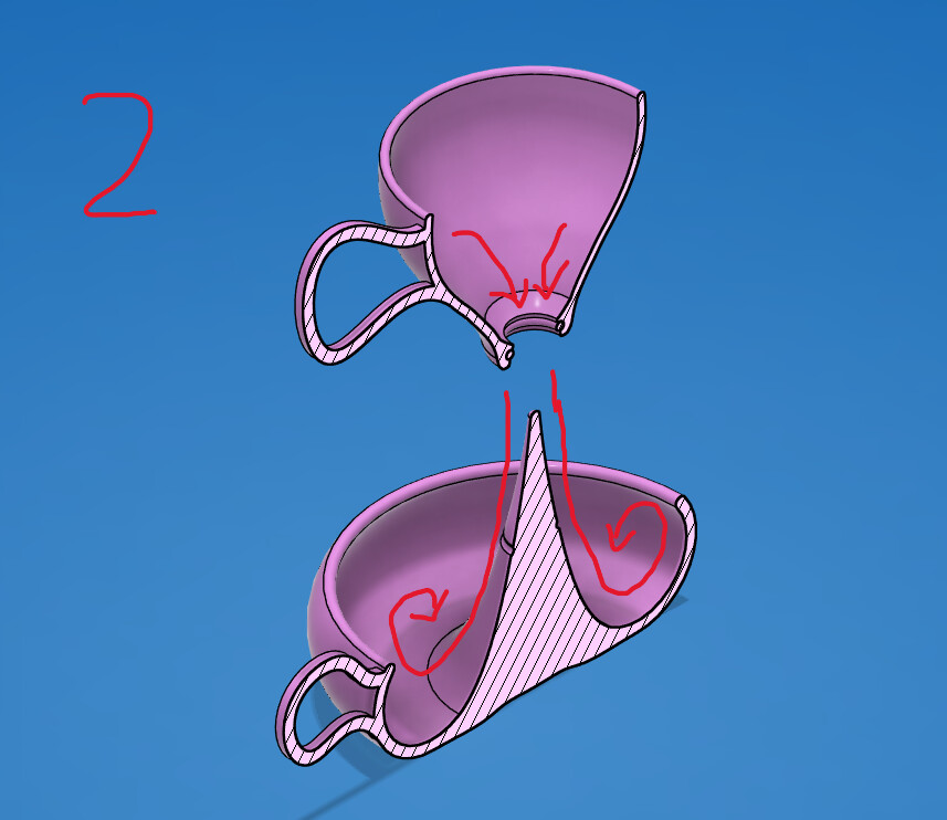

hello, as you can see from picture 1,2 ive designed a cup that dumps the liquid on to the saucer to create a donut shape, I want to recreate this in multiphase simulation including animation of the cup going straight up (also there is a oring at the bottom of the cup) and the liquid falling down, ive tried modeling the liquid as a solid body and bringing it in to the software and tried multiple times with different settings to get rid of the setup errors with no results. Im currently relying on AI to walk me through the steps but it also got me no where, if you can guide me to where should I look at or what problem I should solve first let me know.

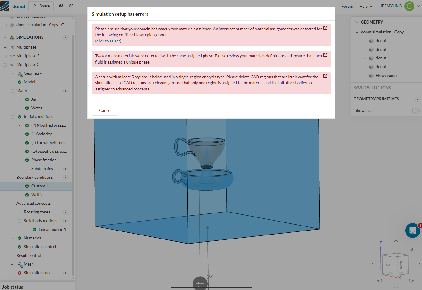

The multiphase analysis type requires you to have a single flow region and no solids. From your screenshot, you seem to have 5 volumes (4x donuts and 1x Flow region) while you should have just 1: the flow region.
