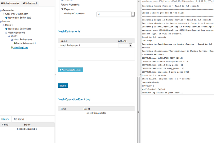

I wanted to do a simulation of a gear pair but already failed at the meshing part.
The log says:
Searching Naming Service + found in 0.1 seconds
Logger server: put log to the file:
Searching Logger in Naming Service ++++++ found in 3.0 seconds
Searching /Registry in Naming Service + found in 0.5 seconds
Searching /Kernel/ModulCatalog in Naming Service +Warning: this sequence type (GEOM/ShapeError,GEOM/ShapeErrors) has unknown content type, it will be ignored.
RunStudy
Searching /myStudyManager in Naming Service +++++ found in 2.5 seconds
Searching /Containers//FactoryServer in Naming Service +Report : 1 unknown entities.
DEBUG:Thread-1:RELEASE PORT (2810)
DEBUG:Thread-1:read configuration file
DEBUG:Thread-1:load busy_ports: []
DEBUG:Thread-1:write busy_ports: []
DEBUG:Thread-1:released port port: 2810
Start SALOME, elapsed time : 10.9 seconds
createNewStudy
extStudy 1
addToStudy() failed
Terminating SALOME on port 2810...

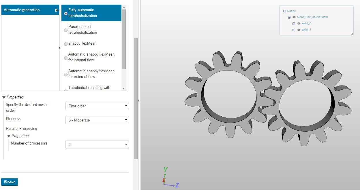

These are my settings:
Anybody has an idea how I can do a better mesh -or first- solve this problem? :smile:
Thank you very much. I will keep trying!
Update: Still was not able to mesh my geometry. Also tried Tetrahed. with refinements in the area of contact. Failed meshing again.

@jousefm,
mhm - did the operations log (not the meshing log) say anything?

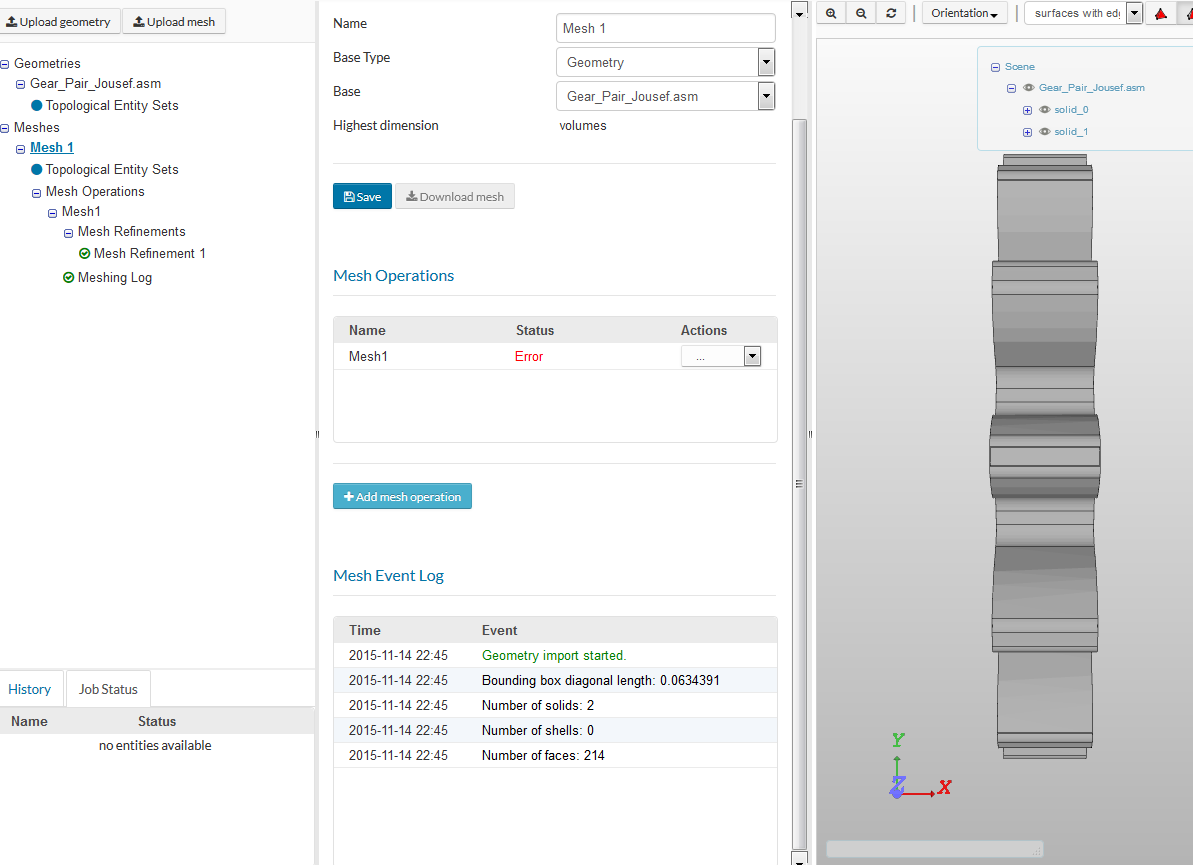

Hi @dheiny,
as I see nothing if you mean picture number 1 (Mesh Operation Event Log).

Hello @jousefm,
I had a close look at the problem. It is obviously related to some Meta-data that comes with your step model, storing some presentation information (like visibility) and I think also material data, that can not be imported properly by our mesher. We are looking into this right now in order to fix that for future cases. Can you tell me which software has been used to export that model.
In the meantime should I share you a project with the cleaned-up geometry or send you the file, so that you can proceed with your work?
Thx for reporting that Jousef!
All the best
Alex
