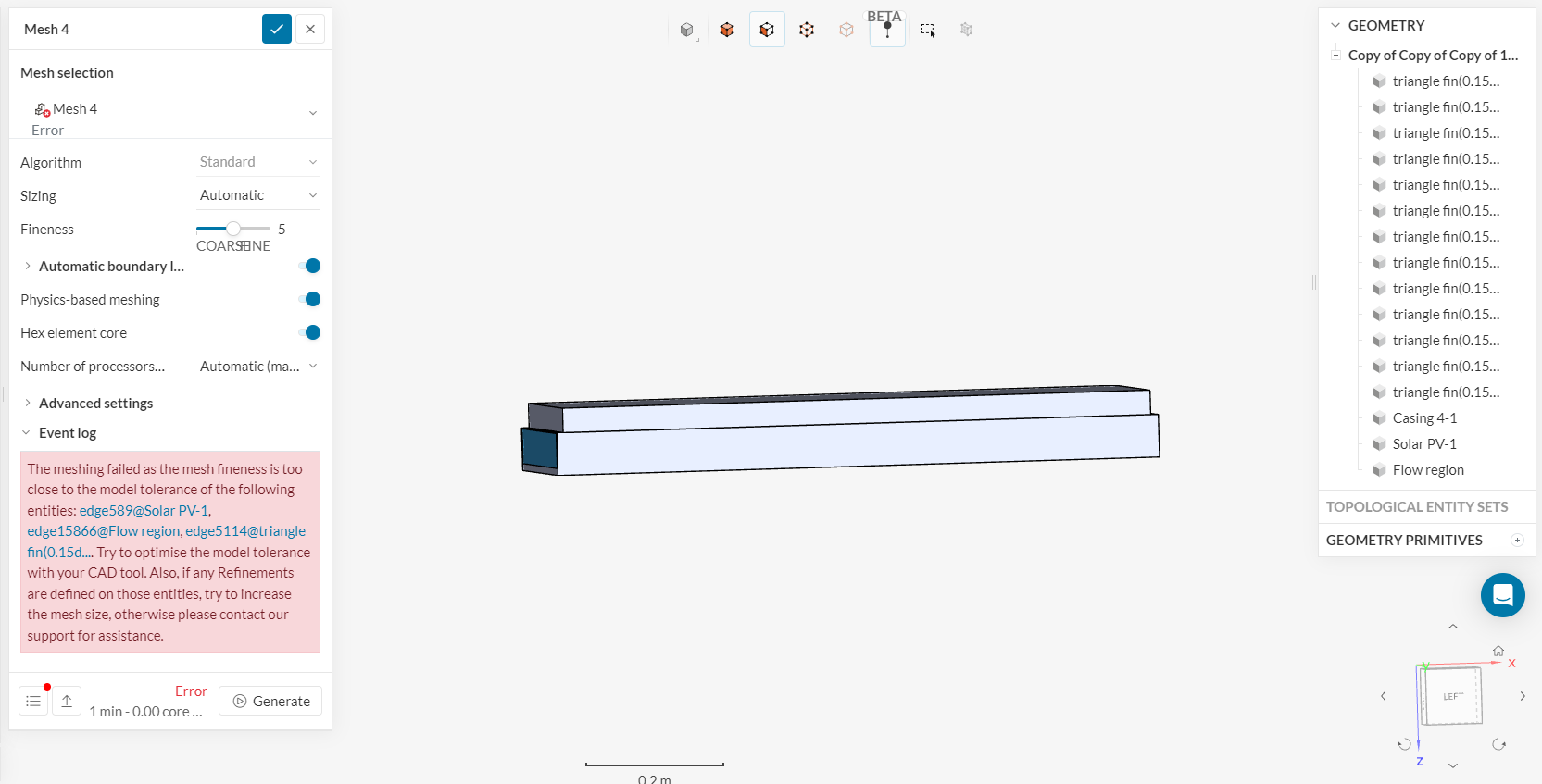

It just fail sir the simulation…can you help me to try until the simulation can be done 100%. thank for your help

It is not possible to deal with the small thickness of the triangles without applying a dense and expensive mesh refinement. Thus in this case, as mentioned before by my colleague in this another topic below, you can simply use the CHT (IBM) to avoid that high computational cost.

thank you very much sir for your help sir. Really appreciate your effort to help me solve this problem that been facing me for a while. Your help will definitely help me in completing my final year project.
