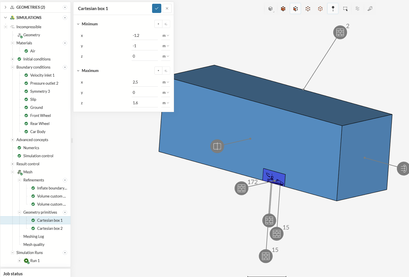

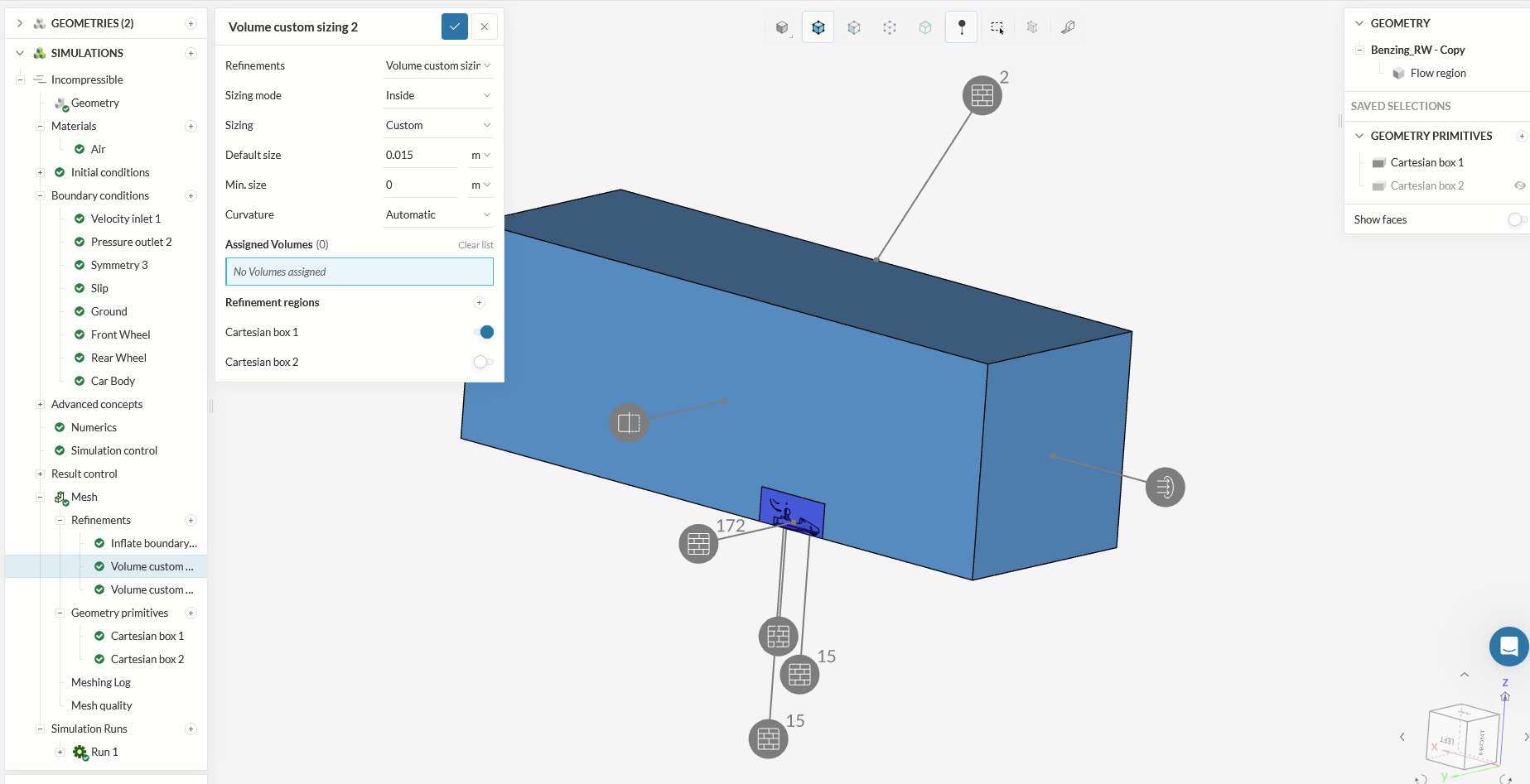

Hi! I am currently using cartesian box primitives to volume control mesh a portion of my flow volume like so:

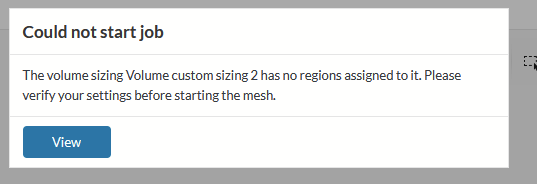

These jobs have meshed correctly in the past, however when I try to remesh I mesh I created ~15 hours ago, these jobs fail with the following error message:
Because theses are the exact same settings as before I suspect that there was a software update that changed the logic of these volume meshing controls - any help would be appreciated!

This a known issue the team is already working on fixing. I will let you know here as soon as a fix has been released.
Thanks for your understanding. :slight_smile:
Satvik
I’ve found out that if you create a simulation and start it, it would start generating the mesh and just remind you of the bug. Currently it works for me. Hope this helps!
Hi all,
A fix has been released and the mesh should be generating normally now. Let us know if the issue persists on your end and feel free to share the project URL in that case.
Thanks @bcheese for the workaround. :slight_smile:
