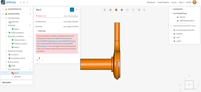

I am trying to simulate a Centrifugal Pump. It is showing the following error. Could someone tell what it means and tell me what to do about it? The pic is attached

from what I can see from the image, I guess that the faces in the MRF zone might also be included in the wall boundary condition. Please check that boundary condition.
