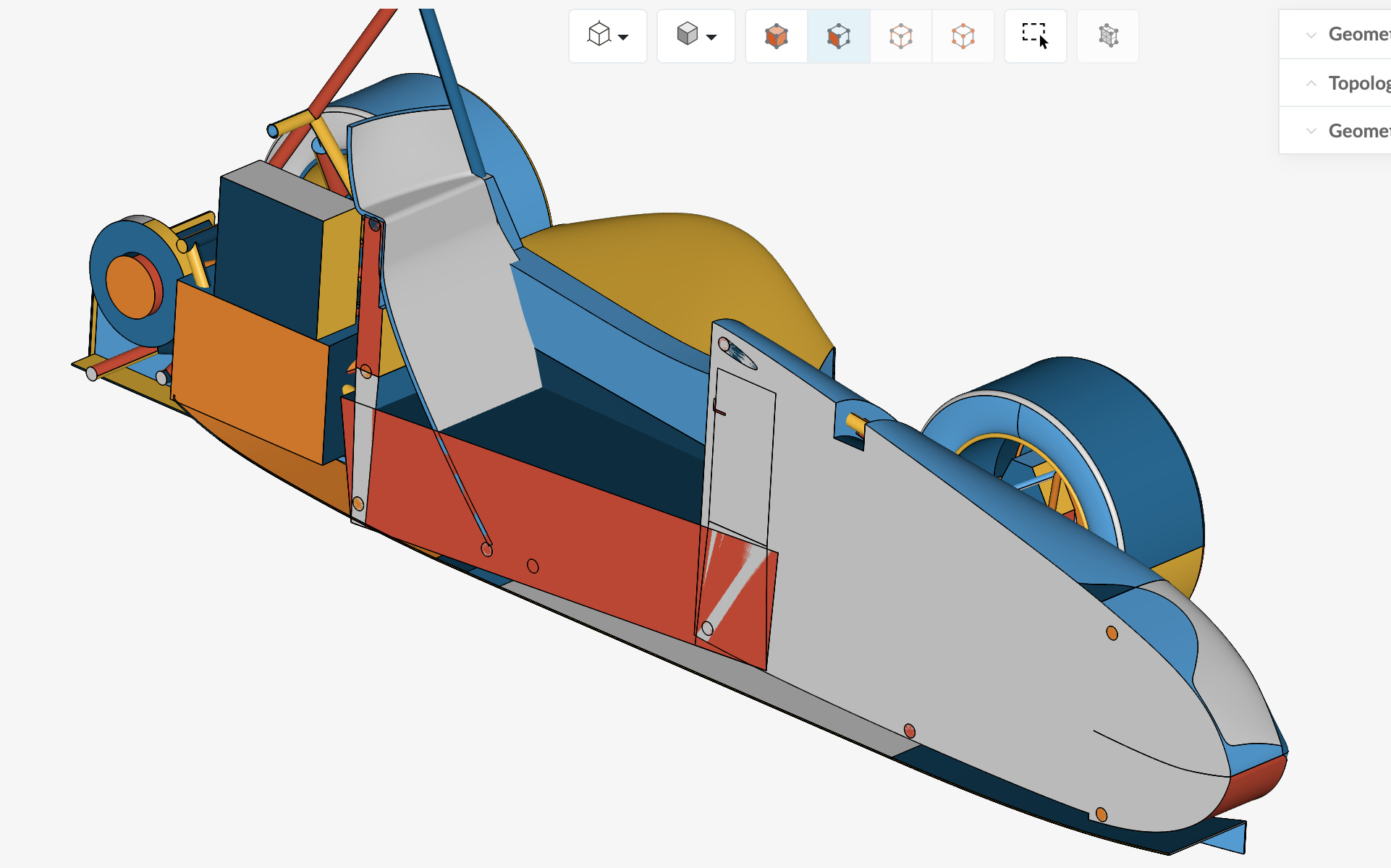

Hi! I’ve been trying to mesh and get the flow around an FSAE car. Initially, I’ve already done meshing once successfully and while Simscale said the mesh quality wasn’t okay, the simulation still ran (although it gave absurd results probably because of bad mesh). Now, I’m trying to make a new mesh under the name of ‘Final mesh’ in my project with more thought after refinements. When I try to mesh, it stops within two minutes. With no meshing log displayed, I’ve no idea what to do about it. Here’s the link to my project.

The mesh cannot work because you have plenty of overlap on your geometry as can be seen in the picture below - please fix that before proceeding with the other steps.
