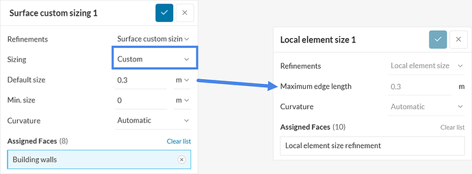

The equivalent setting would look like this for the old “Local Element Size”:

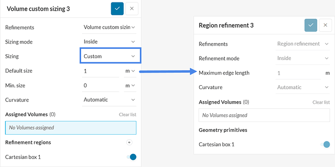

And like this for the “Region refinement”:
Basically,
- Set the sizing to “custom”
- Set the value for “Default size” as you would “Maximum edge lenght”
