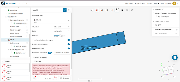

However, when i try to generate mesh around my car for the cfd analysis there is a repeated error
here is a picture
in case if the picture has not shown up, here is what the error log say :
The chosen small feature suppression tolerance is too high to properly resolve the model. It is not recommended to choose this value close to the model’s dimensions but at least two orders of magnitude smaller. See the geometry event log or the viewer scale for the dimensions of your model.

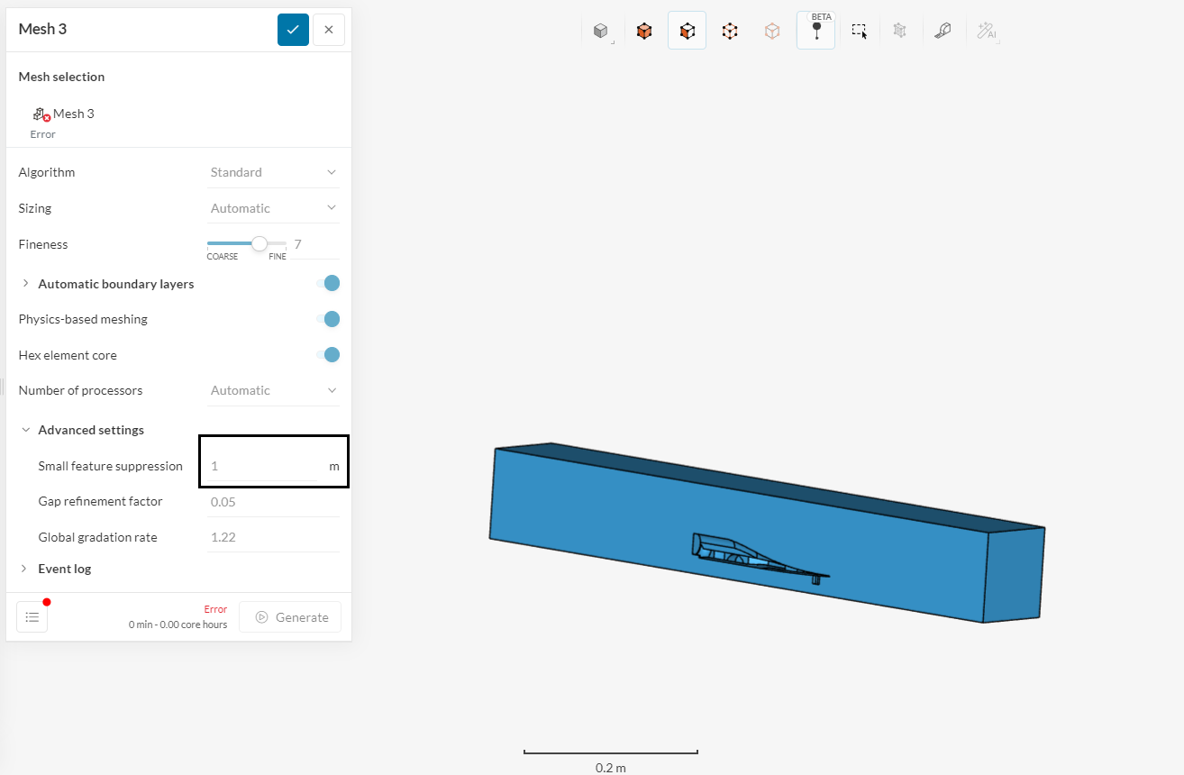

the issue is related to your small feature impression. This set to 1 meter, where your Flow Domain has a length of 0.7m meaning all fces will be suppressed by this setting.
I’d suggest restating these values to default and only increasing this value if you are facing issues with your mesh.
Best Sebastian
thanks for the help. I was able to fix the problem!
