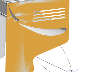

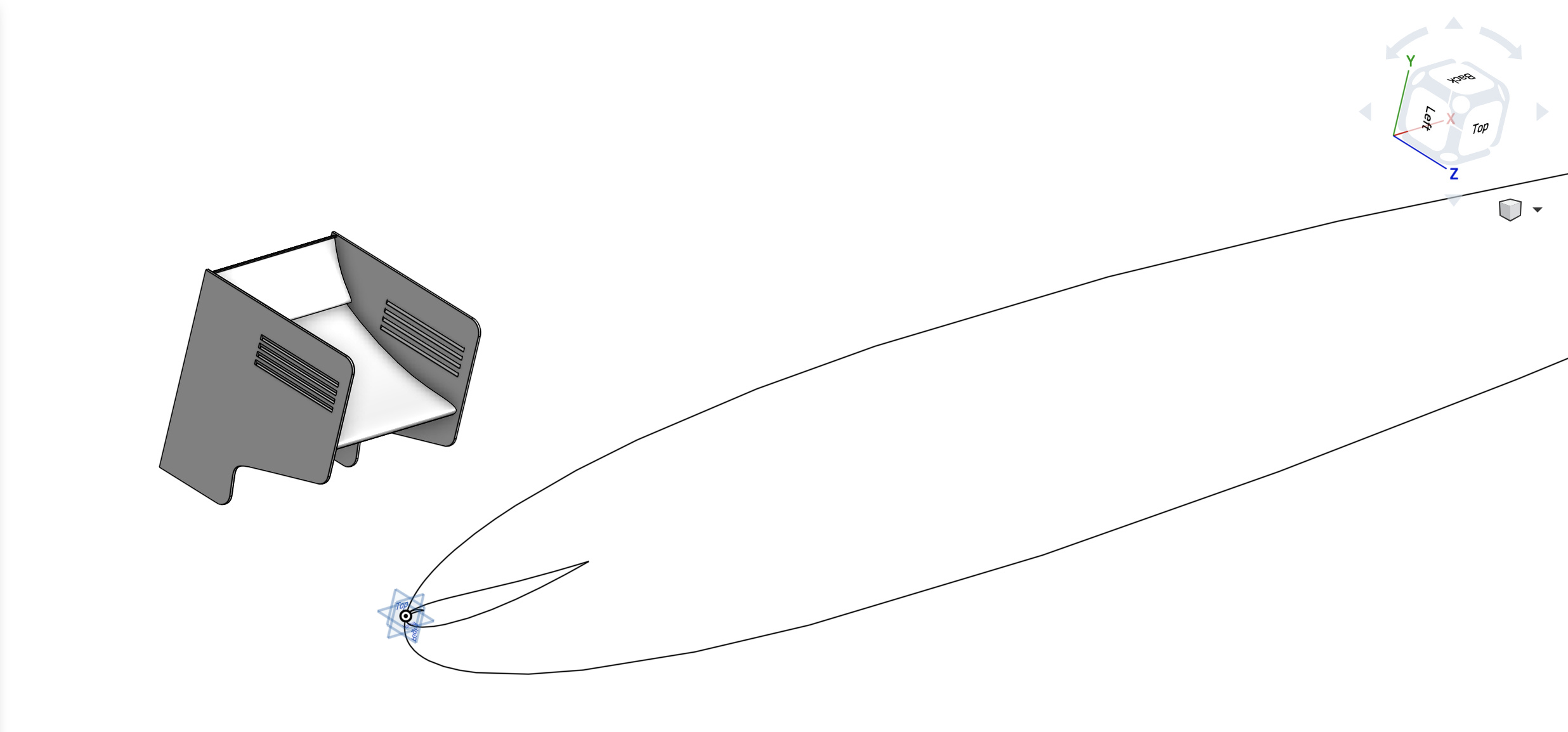

Finished the mesh now. Sorry for the small delay :wink: Main issue was that I had to clean up your geometry. In the first picture you can see that there is a random spline and in the second picture you have had overlapping surfaces (4 overlapping surface overall).
Fixed the issues inside OnShape and reuploaded the geometry. It is called FlapOptimized inside the project. Already ran a mesh with refinements as well as boundary layers. Feel free to adapt the settings to your needs and let me know if you have any other issues :slight_smile: I sent you an invite to your project!
