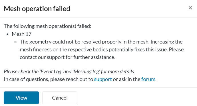

Mesh failed
what does this error message mean? i have been using the same mesh settings on very similar models and this is the first time i got this error.
here is a link to the geometry.

Hello revolateracing,
please have a look at this refinement region, you defined a region with a refinement size of 0.05m which seems pretty rough to me.
