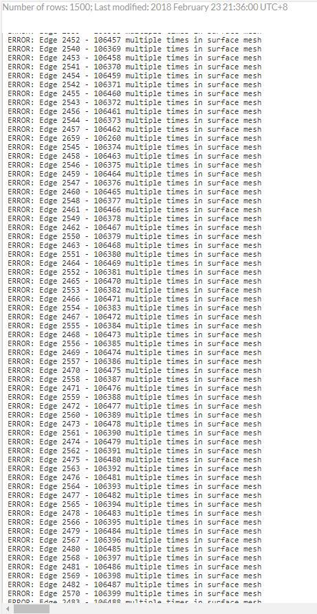

Hi. I am new to Simscale. I am creating a mesh so that I can perform further analysis on the model (e.g drag and stress)
But there are many errors, I don’t have any idea to solve it. Please help, Thanks!

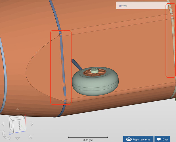

Make sure that faces do not overlap as well as not solids intersect. For the drag study you might use the parametric mesh option and the tet-dominant one for the stress analysis. Attached you will find a picture that shows the problem with the overlapping surfaces.
