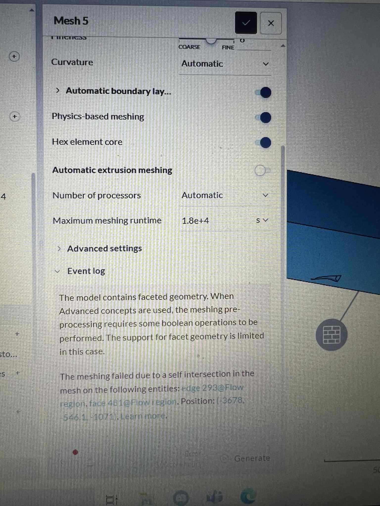

Hi I have this error on my project and I can’t get a solution. Can you please help me? Thanks a lot
Hi @mec272017147, thanks for posting!
As a first piece of advice - I see you’re using faceted geometry for simulation, I assume an STL file? We usually advise users not to go with STL for OpenFOAM studies due to their faceted nature and the potential problems this might cause in the meshing step. Take a look at this post for a more detailed discussion.
That said, I would probably say your issue with self intersecting geometry comes from that.
