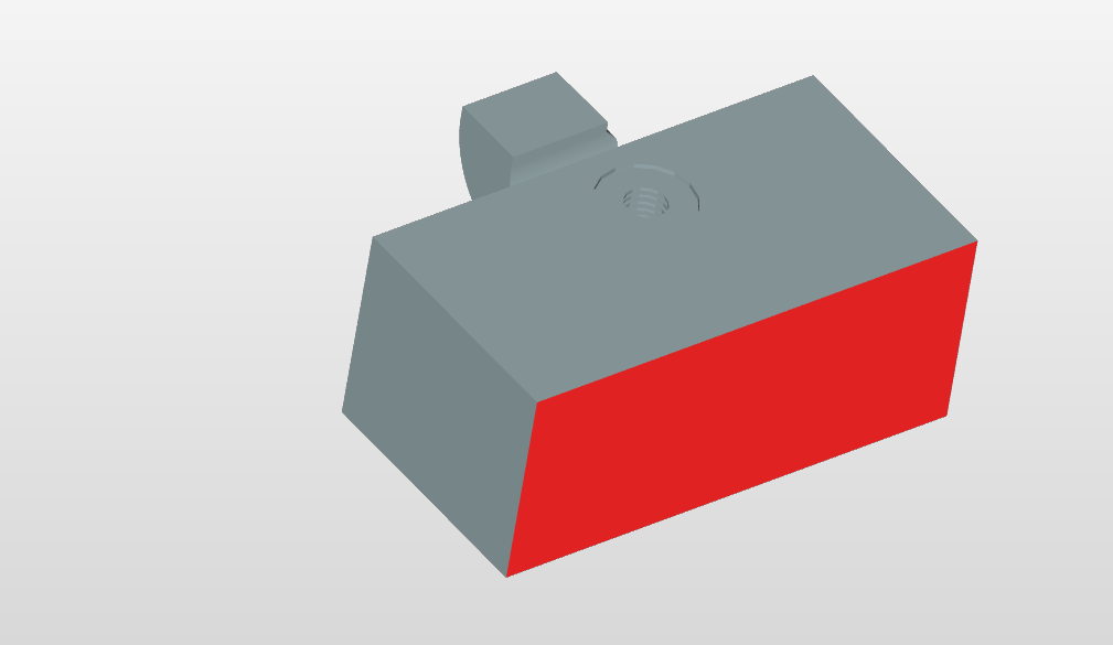

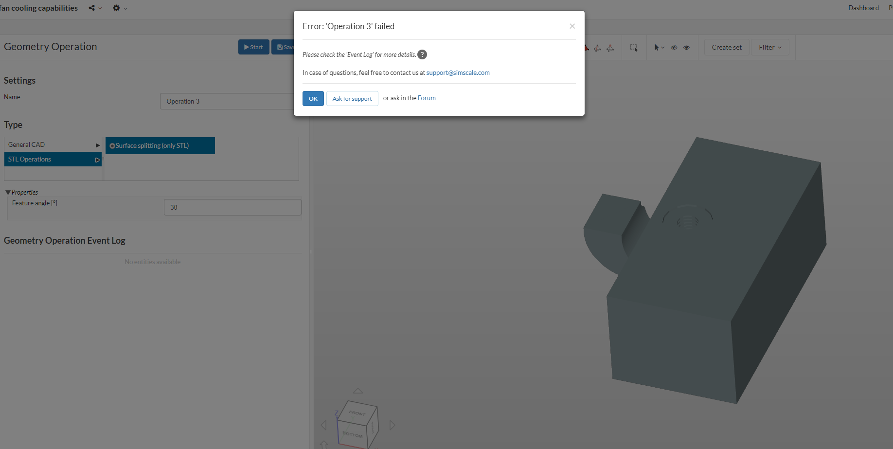

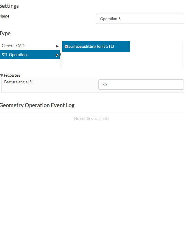

im trying to split the edges on my stl mesh to allow me to select faces to set up an internal flow (prior to this i had only done external flow) but it crashes out, gives me an error but no meshing log every time

Is there a way you can export it from Meshlab already splitted? Tried it once with the STL splitting operation but keeps failing until now.

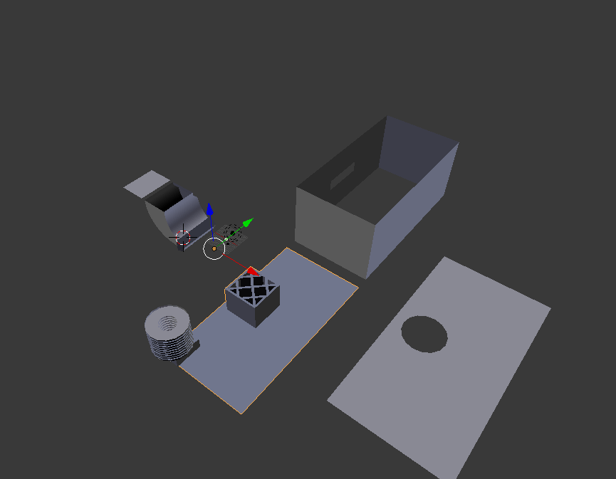

i tried splitting in blender and splitting each face group into its own object, havent found the splitting setting in meshlab yet

You could also use the Split operation provided by OnShape. I am not aware of a method enabling you to split faces in Meshlab. I mean as shown Blender can do it but will it also export the model with split faces?
just ran this and both binary and non binary failed, will look at onshape

You did use the split operation on OnShape, right? Awesome! For me this worked in the past when I tried to split faces.
