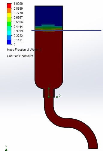

I am not able to make my project converge, due to the mesh. The project is a bottle with a water tap attached. The bottle is almost half full with water and the rest should be air. I have done this setup in SolidWorks and it works.
i’m trying to figure out how long it takes before the bottle is empty.
Picture of SolidWorks:

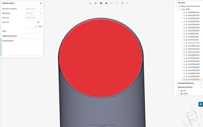

I have tried changing the mesh to fine, and also tried to use another mesher. I have also tried to change the boundary conditions of the model but nothing seems to work.

i have a question about your choosen boundarys.
It showed, that you selected the outside areas, is this correct ?
After i look at your SolidWorks Picture, i think you like to simulate the inner volume of your geometry, not only the ring gap ?
I made a finer mesh and changed the boundary areas, may it works
