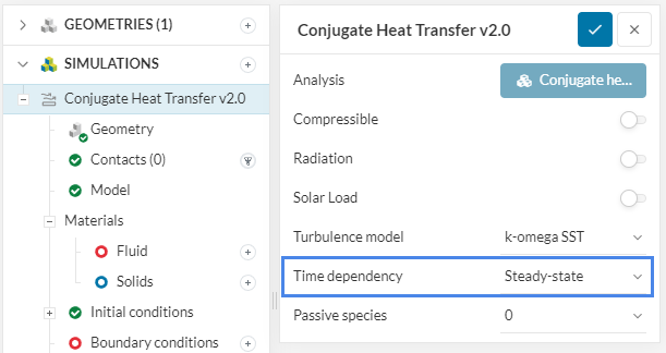

I don’t see an option for steady-state simulation for Conjugte Heat Transfer analysis. Perhaps i should use a diferent type of analysis? if so - what it would be?
Mantas
You can find the option under the general simulation setup panel:
