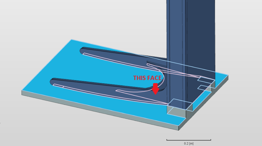

Please be aware that one face can not be a slave face of different contact definitions simultaneously. The same goes for slave faces of Contacts. On top of that make sure to start another iteration with a second order mesh. I have successfully been able to run a simulation with a bonded contact definition without any error.

@gkotelnytskyy try removing the upper slave physical contact face of the table which has been given to master of the bonded contact. This will work!

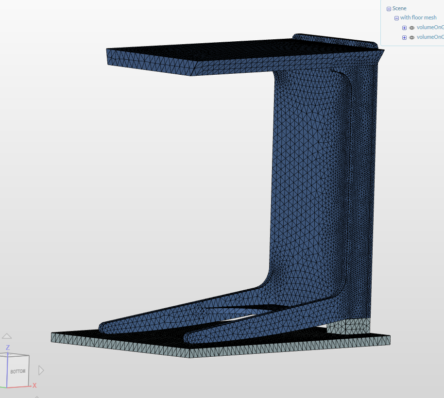

I’ve tried constraining the whole volume, but when I select “fixed volume” constraint – I can’t select the solid, only faces can be selected
just remove all the faces and then from selection options select ‘Assign volume’ and then select the volume. It will then put that volume under your selection box
volume
@ahmedhussain18 deselecting faces worked, thanks!

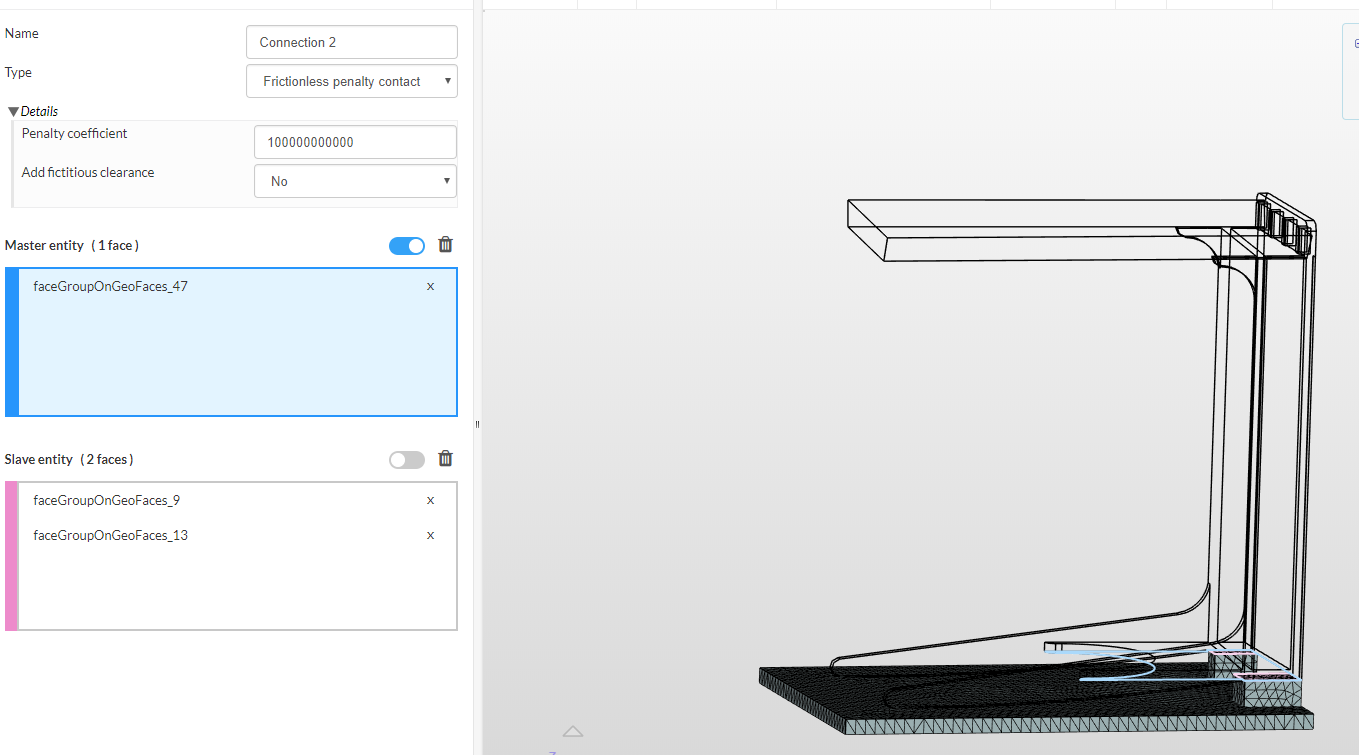

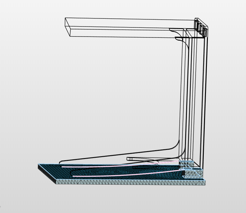

So I’ve defined two physical contacts:
  1. lower floor - to cantelever legs:
  2. upper layer of the floor - to shelf, with master-slave swapped, not to have same entity as slave in two contancts:
  3. As I was getting “unrestricted rigid body motion” error – I added elastic support.
