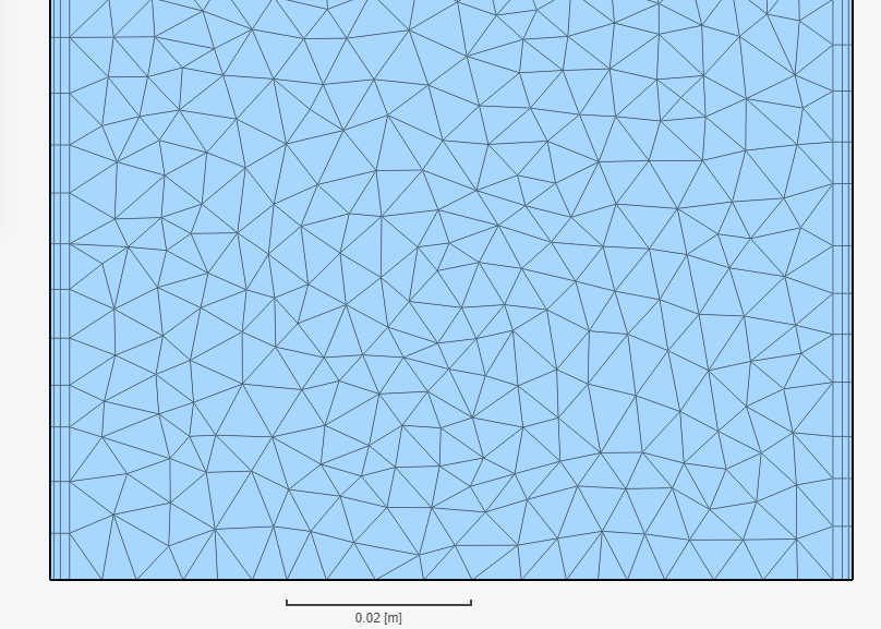

Hi there, would it be possible for someone to tell me how we can find the local cell size please?
Hi!
We do not actually have a dedicated tool to retrieve cell size.
You can nonetheless approximate the size using the ruler at the bottom of the viewer:
In this case you can see that there are 4 cells in 0.02 m, thus the local cell size is 0.005 m.
okay thank you!
