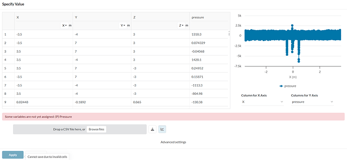

i have done my cfd simualtion and exported the reuslts , used paraview and downlaoded a csv file for presure paramater , it has got 4 columsn x,y,z and pressure while importing it to static structural am experiencing some errors like ( some variable are not yet assigned ) but there is no dropdown in 4th column for me to assign it ,

The Variables in the .csv file must be verified and u have to mannually click on any if the cell in the particular column to enable it , am not sure if this is a bug to be fixed or if this is the procedure , but clicking on cell from that colum or clicking the first cell (variable name ) in that column (in case the previous step didnt work) would enable the variable drop down option
