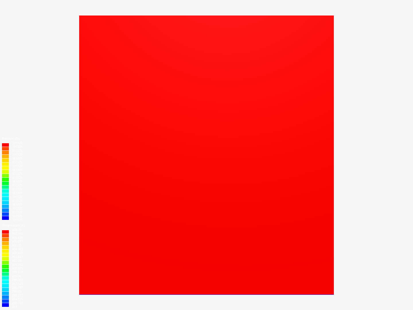

Here my project and runs:

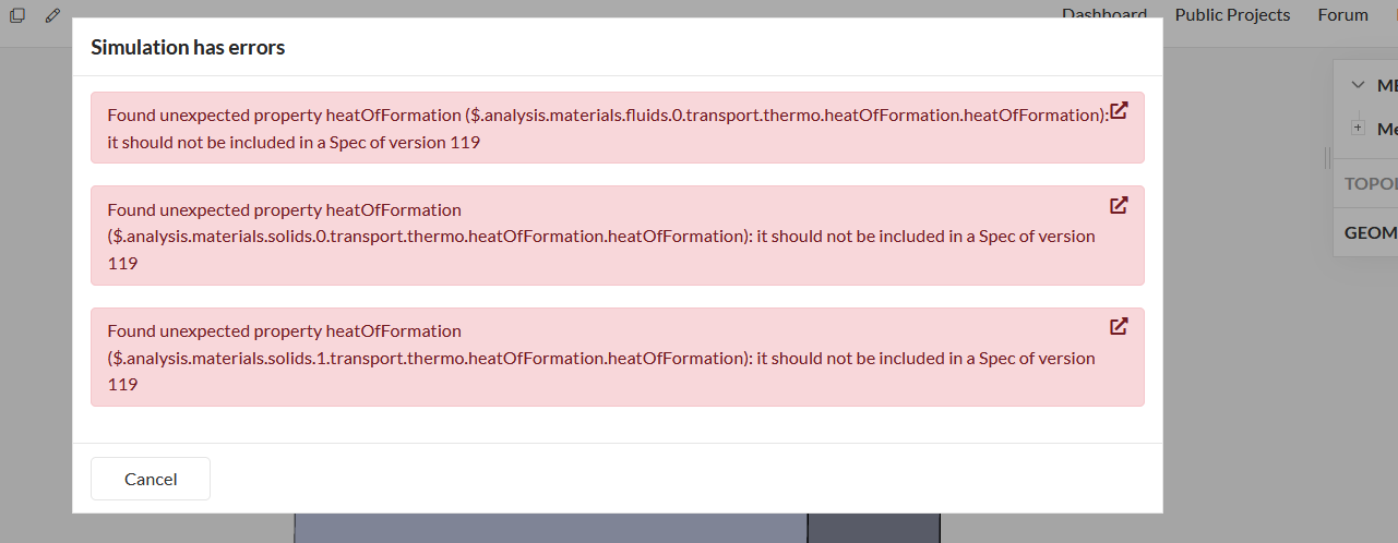

And here my errors:
Hi!
Can you try to refresh the browser and give it another go? The error message should no longer appear.
