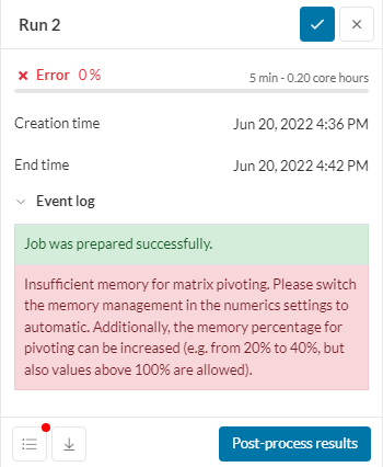

I am trying to run a static structural compression simulation.
I got this error message and the simulation failed.
I increased the memory percentage from 20% to 40% but it did not work for me.
How I can overcome this issue, can anyone suggest me a way?

Hi, did you make any changes in numerics?
Also, the high memory consumption is create by your physical contact and the remote displacement. I think that you can get rid of the later.
Yes, under numerics I only changed the Memory percentage for pivoting from 20% to 40%.
In the next run I will remove the remote displacement, but should I keep the physical contact?
Yes I think, as that is crucial for the model.

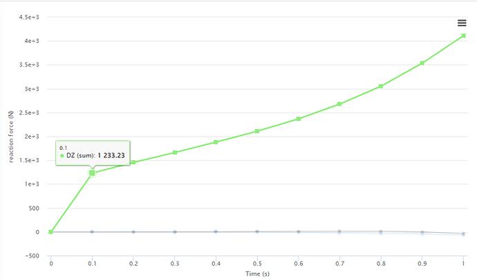

From my force vs time graph, it seems the curve is generated with a few data points.
Is there any way to generate this curve having more data points?

Hi!
You can reduce the ‘Maximum time step’ under ‘Simulation control’ to have more points in the output.
