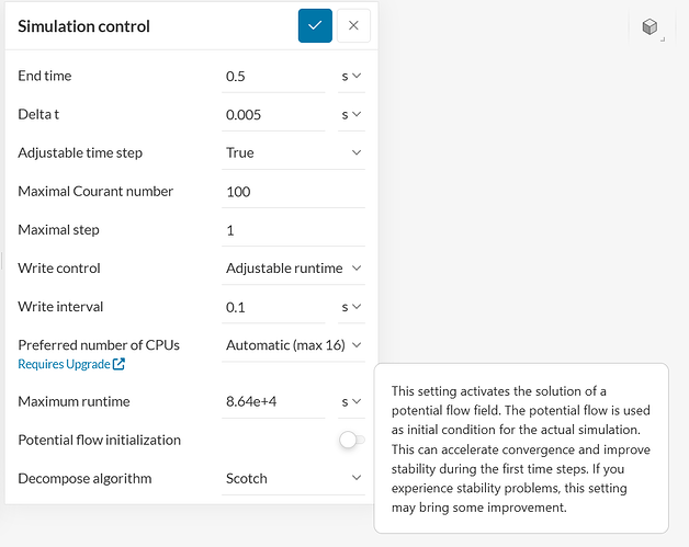

As far as workarounds go, are you looking to initialize temperatures? Velocity fields? What is the solver, more specifically?
Some solvers will have a potential flow initialization option for velocity, which gives you an initialization for velocity. It won’t be fully developed flow, but it can help in some cases:
For temperature, subdomains can help.
