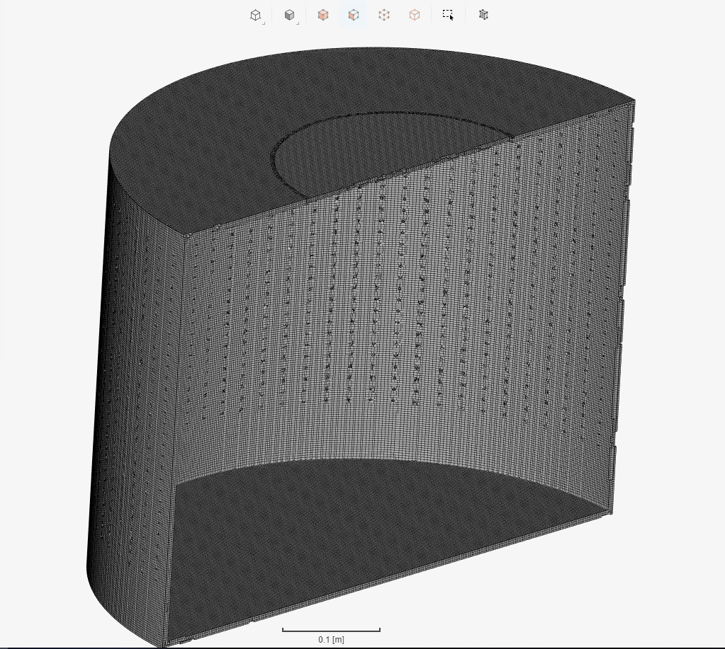

I’m trying to run water flow through the drum with small holes, and i keep getting error “A multi-region mesh was assigned - this analysis-type requires a single-region mesh.”
how can i solve this?

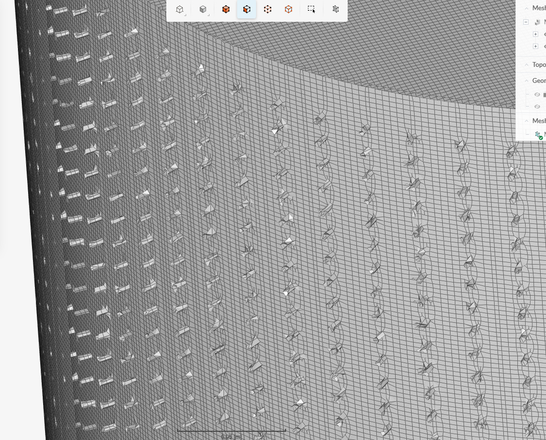

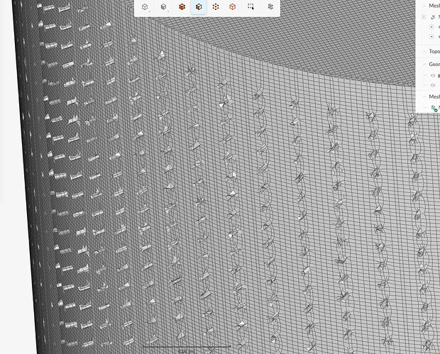

Hi @jeremygs12450f
I made a mesh clip and I believe that this mesh is not what you desire for this simulation?? If its a YES, then I have already told you how to tackle this situation. If you need element inside the cylinder then you have to work upon your double layered geometry. You need to improve the mesh quality around the holes by giving a suitable level of surface refinement.
