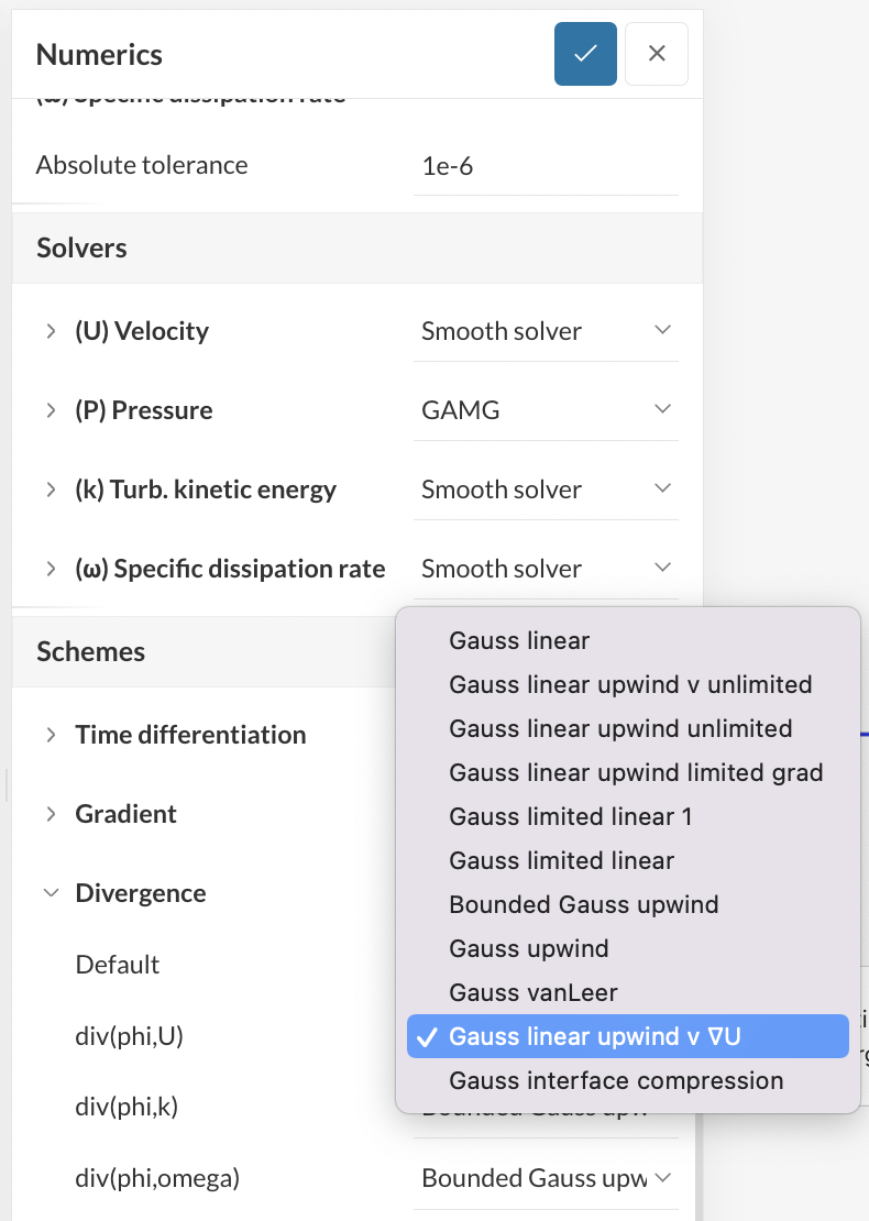

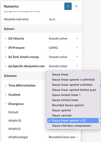

- Numerics: Divergence scheme for velocity, 2nd order i.e. gause linear upwind v nabla U. This should be the default, but it should be checked as viscous effects are extremely sensitive to this.

Thank you very much! I set the mesh type to hex-dominant but thats the only thing I can find. Are the others under simulations controls and it is just me beeing blind or do I have to search somewhere else?
