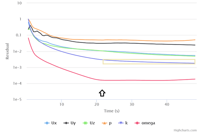

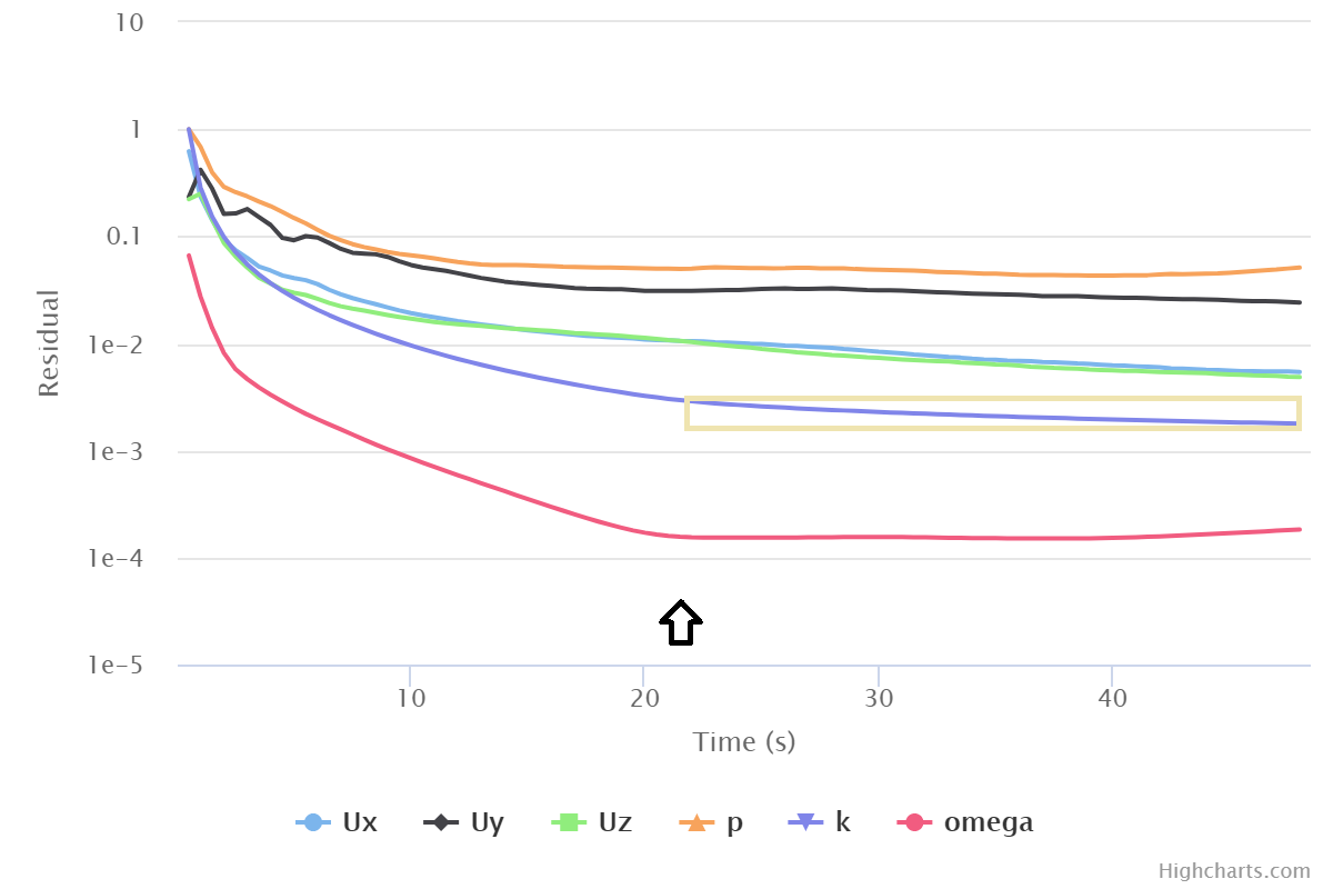

  1. Set simulation time to 25 - 50 ‘seconds’. Use 0.5 sec steps. Write interval, say 6 seconds (it is also equivalence of times 50 -100, 1 sec step, 10-12 sec write interval).
  2. Look at plot of forces: you should discover minimal time to get stable forces.
  3. Look at k plot: you should observe the slope and decide if you have to add time (keeping the step size, but making interval bigger, as system prevents to have more then 12 intervals).

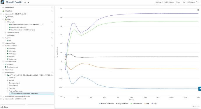

Because I look at the force plots over time, select a lowest point value near the end time, then I multiply that value by 1.01, use that 1.01 scaled value to find out the last iteration that was not above it (this becomes the start of 1% range and the end is the last iteration time).
Then I specify my actual value as 1.005 times the lowest value in the range and the result would be this 1.005 scaled value +/- 0.5%…
When I see stable but fluctuating results, I try to see if the best fit ‘center line’ of the fluctuations is stable to 1%… stable and use the ‘centerline’ middle value for my result value with a +/-% of the peaks of the fluctuation in the range… (this assumes that the fluctuations are themselves relatively small and stable).
Essentially I want my data to be stable within a 1% range over many hundreds of iterations…

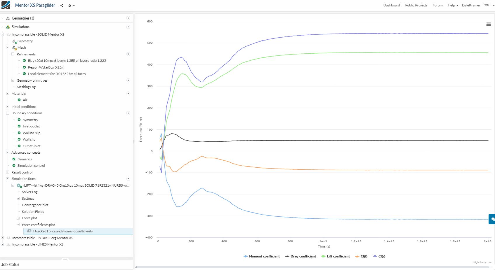

To determine that 1200 was the shortest time I needed, I actually went to 2000s to be able to easily find my 1% stable range and the beginning of my 1% stable range was 1200s, so I use 1200s for my endtime for that geometry and inlet speed from now on…
If you want stable results, it takes iteration… (and cloud time)

  4. K slope would go asymptotically down to a level like 2-e3 or better, for a while. So I can see how much better i will get with k on that hyperbolic curve (yellow rectangle). However your geometry would be microscopically impacted by late development of k: forces should be, for practical reason, preserved.
In that respect, as perfectionist, you need to wait very long indeed. Perhaps better hint will be spot omega not evolving anymore? :man_student:

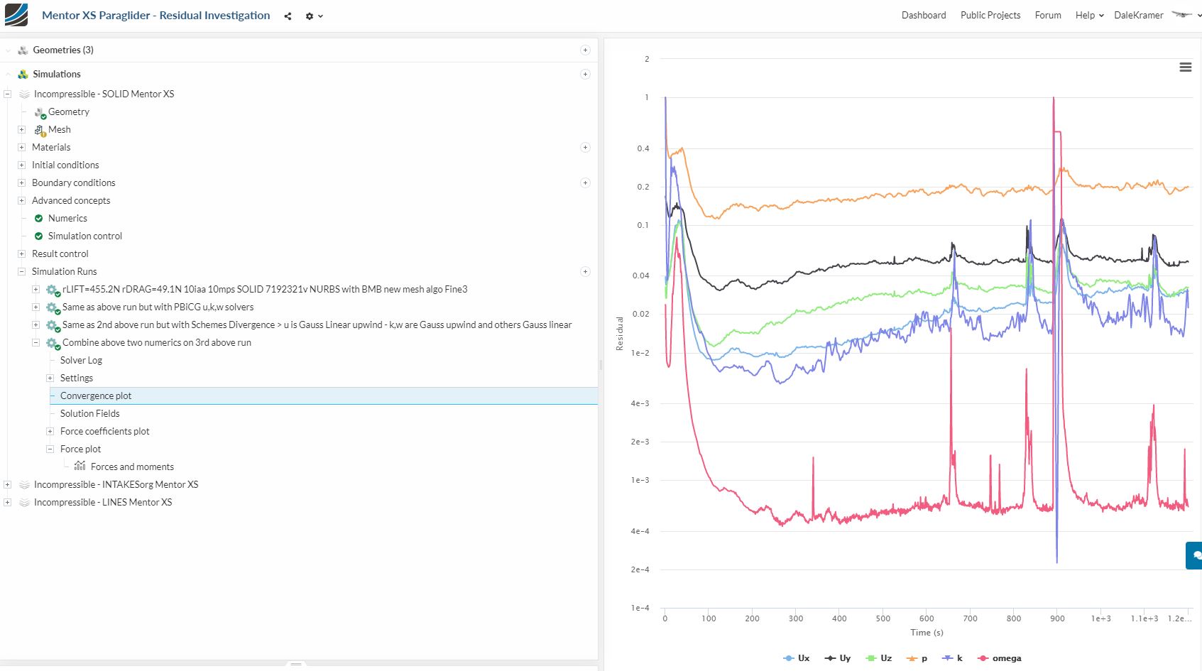

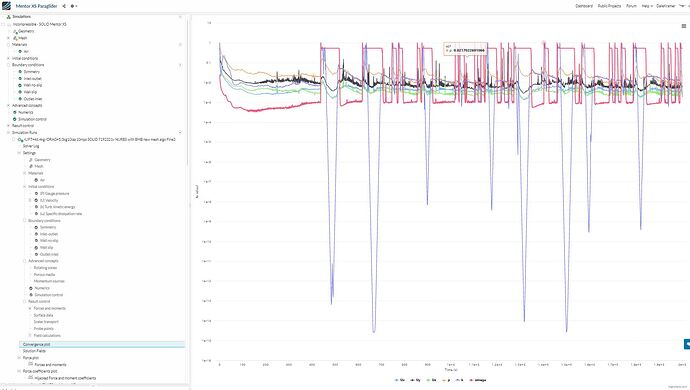

@DaleKramer: project took some time to downloads to the World’s Edge, but now I can only say that your validation of rotated inflow is impressive! :+1: :smiley: As mesh is quite big, forces stabilize only around 800 steps. It should be an example to follow for all cases where AoA or drag / lift should be calculated with precision, however I would prefer a smaller one. In your case paraglider geometry from Rhino shows only ropes: everything looks like a ‘ghosty’ paraglider.

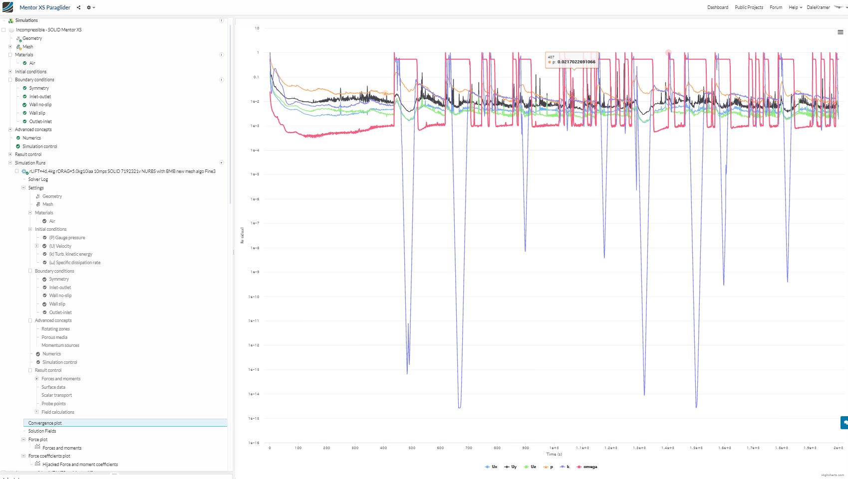

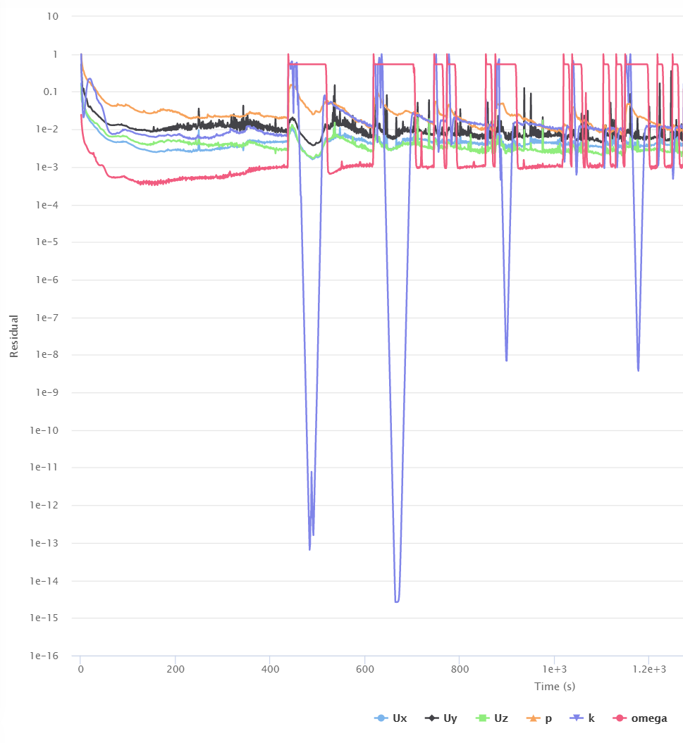

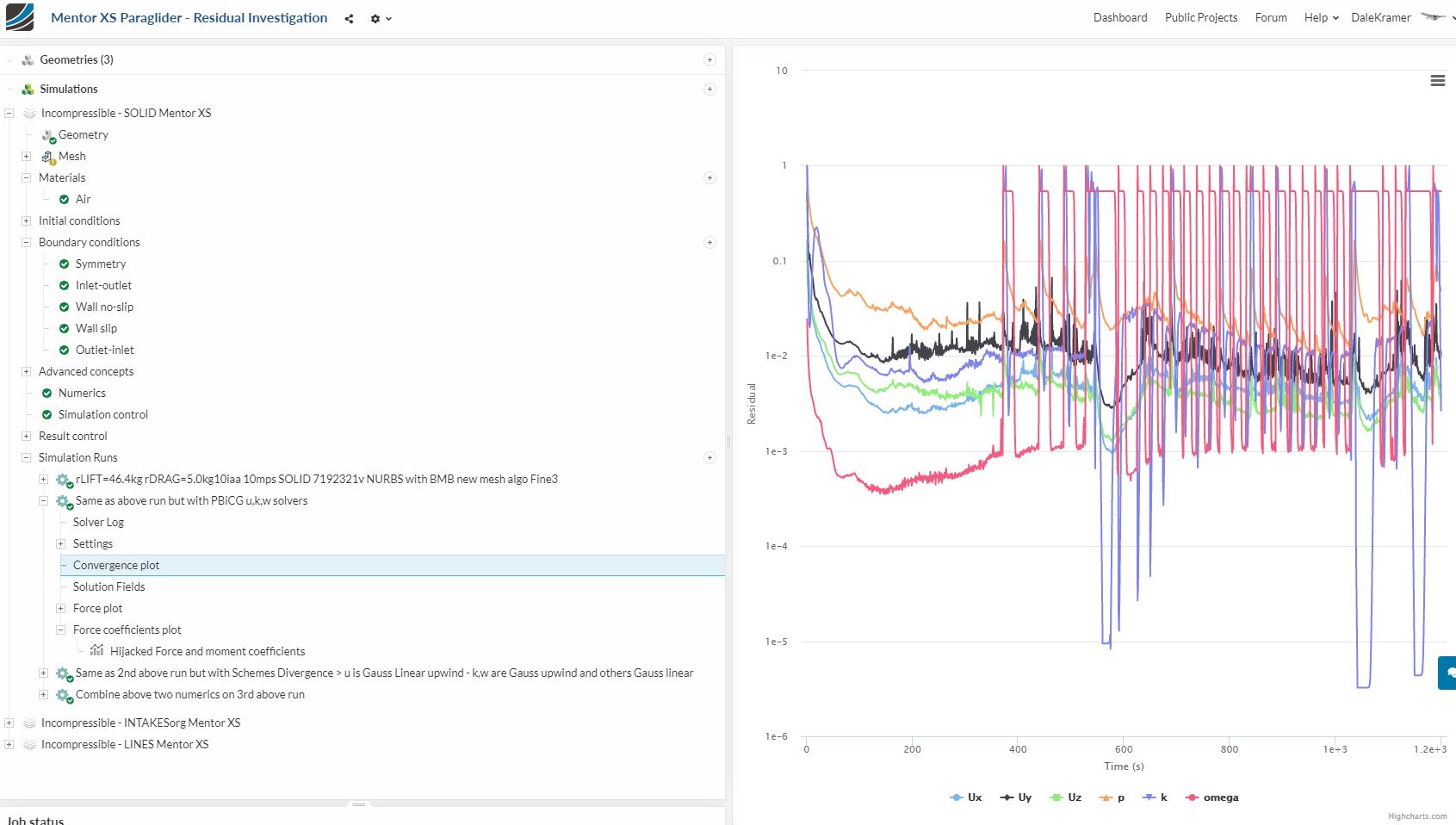

What bothers me is the simulation instability (collapses of residuals), starting from step ~430. K and omega go hectic for ~20 steps, then k tends to 0 in a crazy linear drop, recovering 50 steps later. That residuals instability does not affect forces calculation.
Fragment of convergence plot
Maybe somebody can offer an explanation… :lizard:

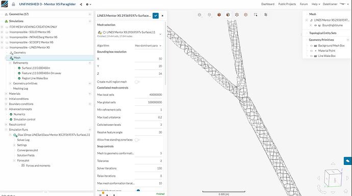

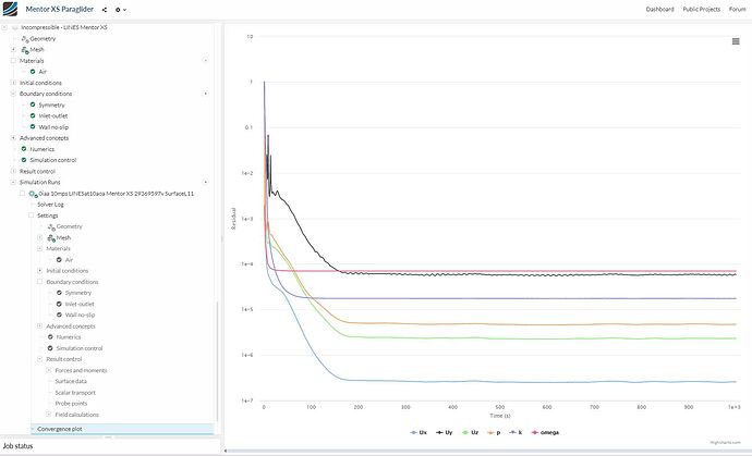

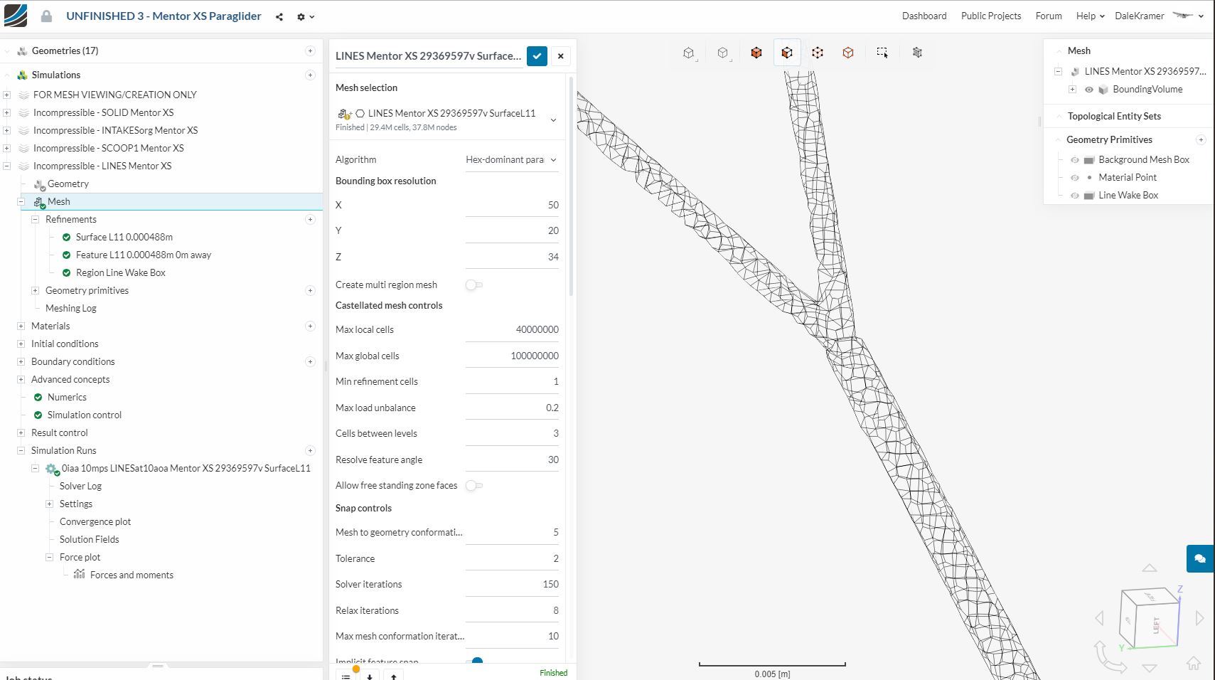

Yes, the ’ Mentor XS LINES geometry’ was extremely difficult to mesh to a 29M cell mesh and I am the first to admit, it is a questionable simulation. Even tho it is hard to see the lines, zoom in the mesh is there… (the lines did not need forces rotated as the lines were at 10aoa in the geometry file and the sim had 0iaa to the domain).
Here is the worst areas of the 29M mesh (ucky but marginally resolved in this small 0.6mm diameter line section):
The link I gave you was to a nice geometry of the SOLID wing only (no lines attached), whose geometry file was ‘Mentor_XS_SOLID_NURBS_geometry_with_BMB’ and it meshed nicely to a mesh named ‘SOLID Mentor XS 7192321v NURBS new mesh algo Fine3’. I have been using the ‘New mesh preview’ meshing algorithm lately and it is much more difficult to get convergence on the ‘New mesh preview’ meshes.
That convergence plot that you show for this 7192321v mesh is typical of my newalgo meshes when I do get them to converge and I have compared results of the newalgo meshes with results from a similar ‘number of volumes’ HexParametric mesh and the newlago results are very close, even with the strange residuals that you show.
As you say, fortunately, the Coefficients and Forces results don’t seem to be funny looking, so I have been ignoring those strange residual plots as long as the force results plot look nice, like this (from the same run as the residuals you show):
That strange residual behavior showed up as I varied the numerics in order to get the force results to stay converged and stable…
I would not believe such a fine structure can be meshed before seeing your exploit. It means that spider webs can be used in SimScale as well. :spider_web: I will be impressed for a while. :man_student:
K collapses we see in residuals may be linked to an infinitesimal residuals calculations / math module precision / rounding errors or something.

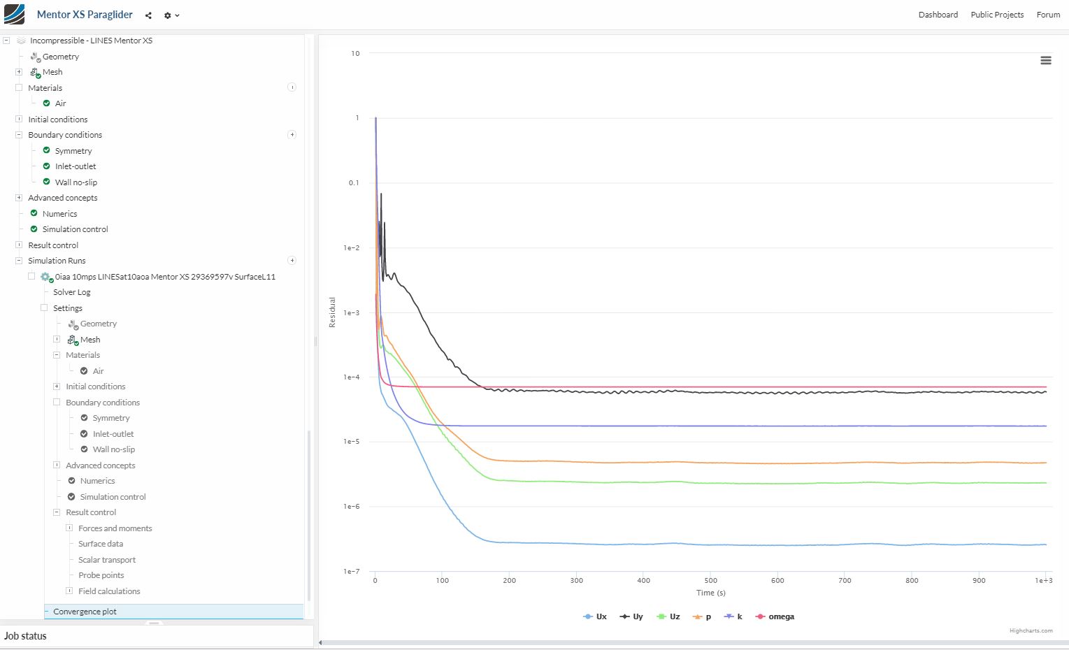

Interestingly, the 29M LINES residuals had no strange behavior.

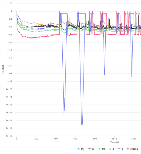

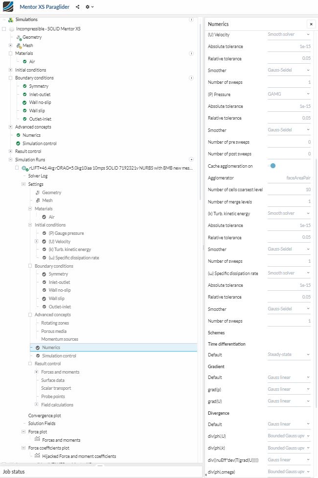

Sorry but I just had to do this :wink: , here are the comparisons of ‘residuals and numerics’ between…
  1. SOLID (wing only 7192321v mesh):
  2. LINES (hanging lines, no wing 29M mesh):

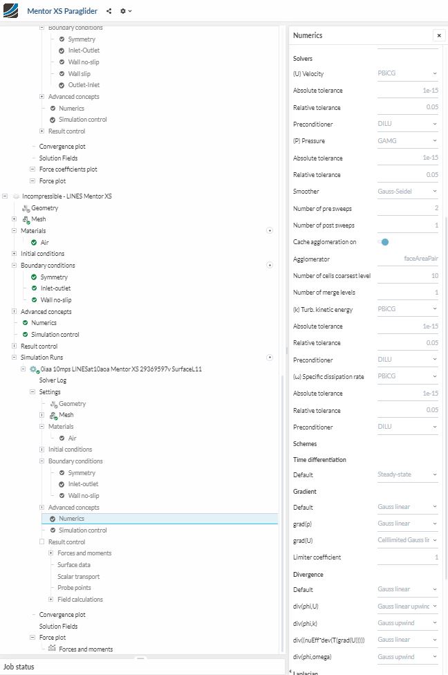

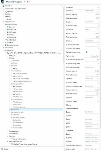

And I have to add an image of the SimScale DEFAULT numerics:
Now I have to get out my magnifying glass to see and analyze the numerics differences :wink: give me a moment :slight_smile:

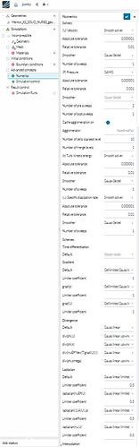

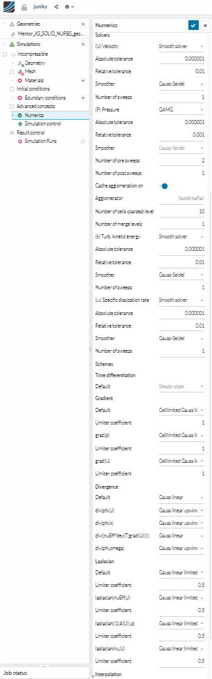

To start with, lets looks at Laplacians:
  1. SimScale numerics defaults Laplacians = Cell Limited Linear
  2. SOLID numerics Laplacians = Gauss Linear Corrected
  3. LINES numerics Laplacians = Gauss Linear Corrected
Now, Solvers:
  1. SimScale numerics defaults Solvers=
    U is Smooth solver U Smoother is Gauss-Seidel
    P is GAMG P Smoother is Gauss-Seidel
    k is Smooth solver k Smoother is Gaus-Seidel
    w is Smooth solver k Smoother is Gaus-Seidel
  2. SOLID numerics Solvers =
  3. LINES numerics Solvers=
    U is PBiGC
    k is PBiGC
    w is PBiGC
Now, Schemes Time Differentiation:
  1. SimScale numerics defaults Schemes Time Differentiation = ALL CellLimited Gauss Linear
  2. SOLID numerics Schemes Time Differentiation = ALL Gauss Linear
  3. LINES numerics Schemes Time Differentiation = ALL Gauss Linear
Now, Schemes Divergence:
  1. SimScale numerics defaults Schemes Divergence = u,k,w are Gauss Linear upwind and others Gauss linear
  2. SOLID numerics Schemes Divergence = u,k,w are Bounded Gauss upwind and others Gauss linear
  3. LINES numerics Schemes Divergence = u is Gauss Linear upwind - k,w are Gauss upwind and others Gauss linear
WOW, looking at all that I am in wonder as to why I changed all those things but, at the time when you are grasping at straws to converge, you do try a LOT of things with recommendations from everywhere.
I make no justifications for the differences, that is just the way they are and all the sim runs have nice stable results…
This is at least forcing me to TRY to get numerics under control again :wink:

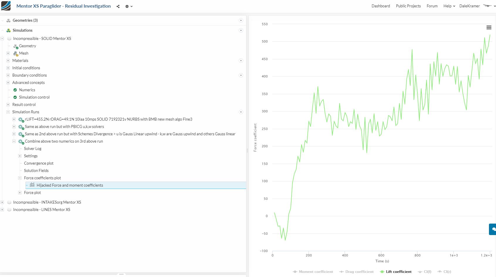

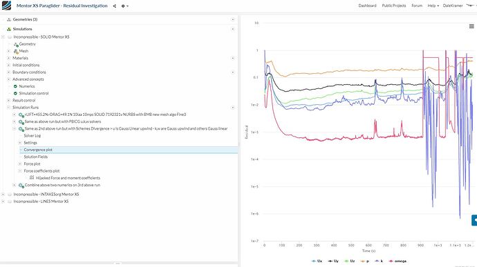

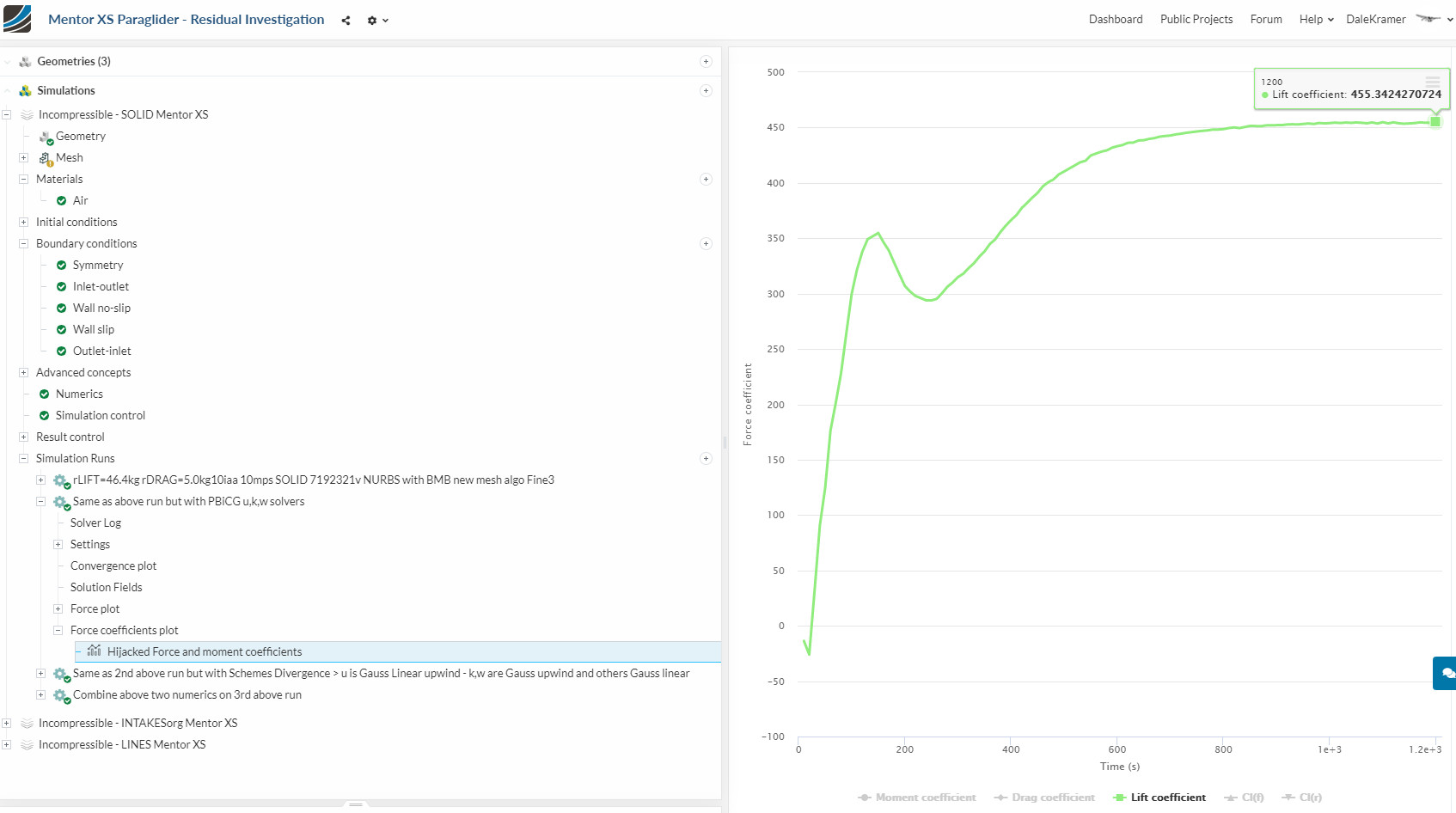

So I have done the above with confusing results…

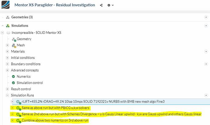

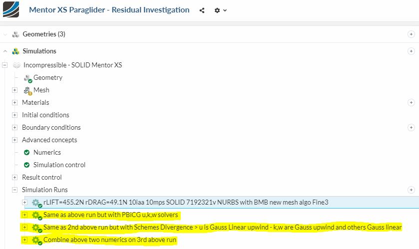

I started by copying the original project to a new one called Mentor XS Paraglider - Residual Investigation
I ran 3 more simulations on the SOLID wing investigation and here is what I named then:

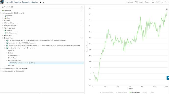

Here are the ‘Residual Plots’ and the ‘Hijacked Force Coefficients Plot for Cl’, for each new run.
Try #1 LINES solvers:
Try #2 LINES Schemes Divergence:
Try #3 LINES solvers AND LINES Schemes Divergence:
SO, while the strange residuals look better, but not gone, on Trys #2 and #3, their Cl plots were all over the place.
AND, Try #1 has slightly earlier appearance of the strange residual behaviour yet it still has a stable Cl and the Cl last iteration value is nearly identical to the first run Cl value (where the strange residual behaviour was first noted).
Conclusion:
These results somewhat backup my theory that the strange residual behavior is related to my ‘magic’ numerics, but the exact reason eludes me…
So ‘Lines solver’ gives stable results, ‘Lines schemes divergence’ is ‘overshooting’ and it is reflected by forces oscillations.
Mixing both is like mixing two medicines: you could be sure to have iatrogenic effects. Hence such a mixing, even in simulation, should be avoided. Nassim Taleb (Black Swan book and others) proposes a new approach to avoid iatrogenic effects: subtraction medical services (instead of addictive). Patients would be invited to provide a list of things they take already (pills, potions, supplements, etc.) and a doctor will ask them to drop most of those drugs. I agree, but for the moment I do not have even an aspirin handy…
