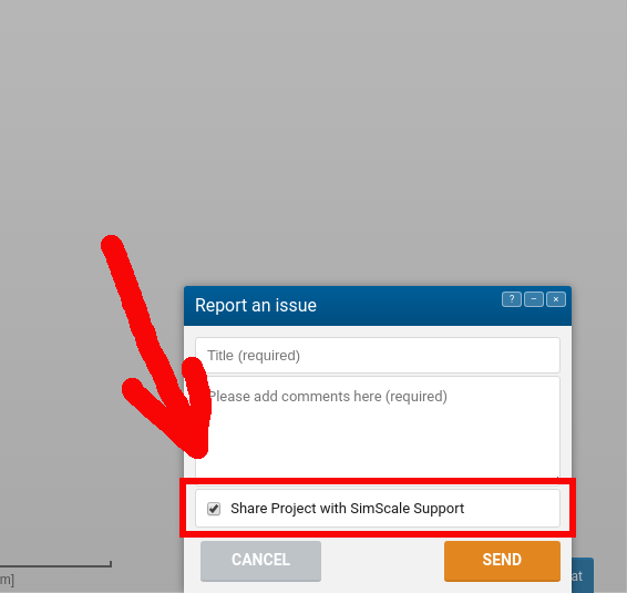

Hi @JaeHoffmanOCC,
so the Onshape import is generally operational - so it could be an issue with your specific geometry. Is it possible that you share your project with the SimScale support such that the team can take a closer look?
David

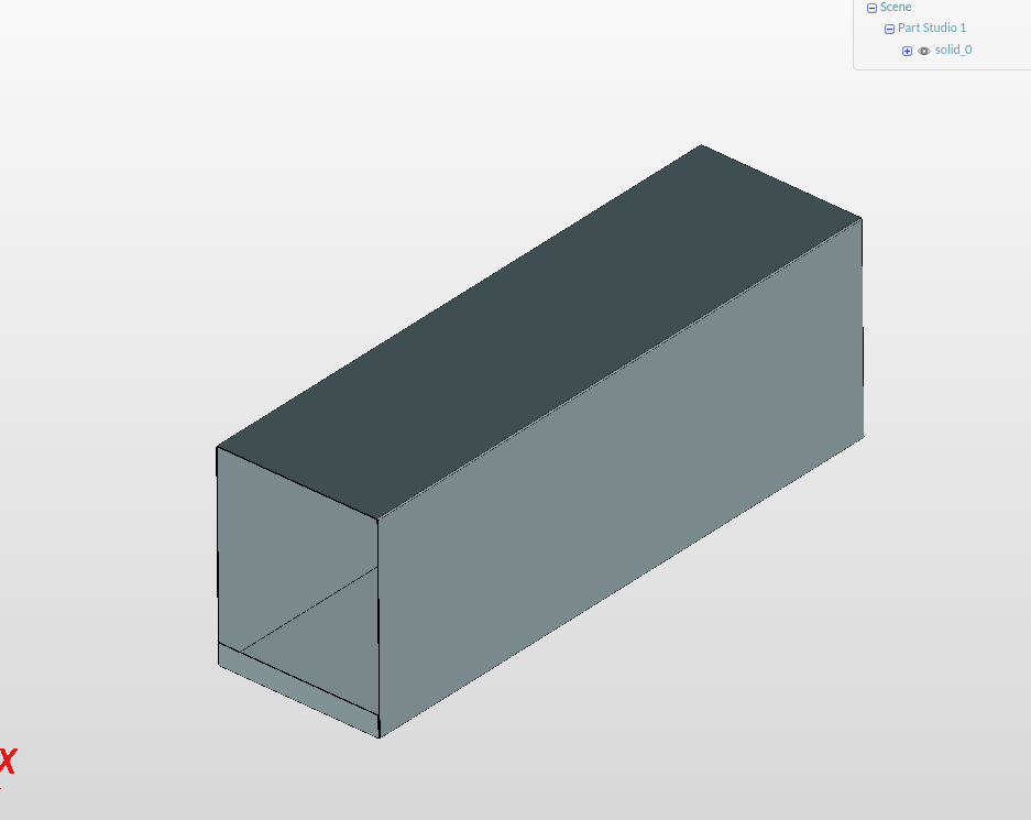

I just shared it.
Thanks. I realized it’s public - so I took a quick look. Seems to work for me:
So it could be your local browser set up. So a next option to look at could be if your browser is supported. You find more info here: SimScale Documentation | Online Simulation Software | SimScale
Let me know if this helps.
So it seems to load in after about 30 minutes of waiting for me. However, I have to quit out of the project and go back to my dashboard, and then relaunch the project to see the imported geometry. Once the geometry is imported, it still takes another 15 minutes for me to see it in the workspace (It says “loading 1” in the top left). I am using google chrome, so I don’t think that is the issue.
Very odd. I just tested it again and it takes seconds until the part shows up for me.
