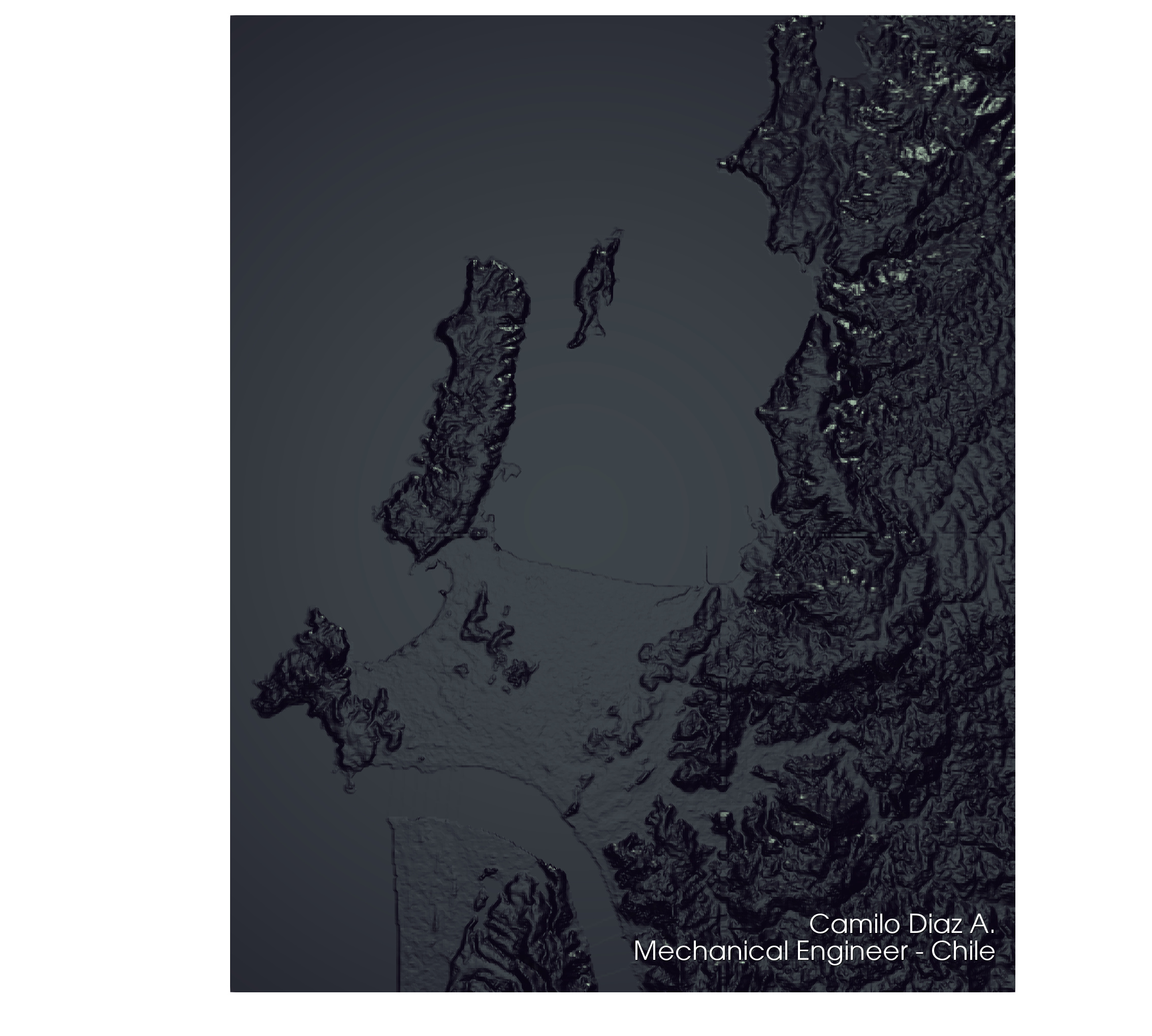

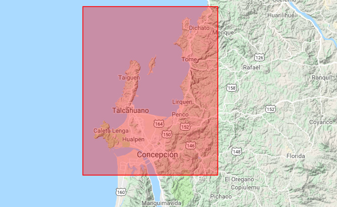

A while ago I read how to import from googlearth. Maybe you may be interested in this Application and example.
It is also necessary in some works post-processing point cloud scans (from a drone) and you may be interested in this other link XTract3D: 3D Reverse Engineering from STL (Scan to CAD) inside SOLIDWORKS - YouTube
I have been with a lot of work, when I have time I can share a model and simulation as an example to simscale step by step :slight_smile:
I complement the post with a piece of land that I got with the app
