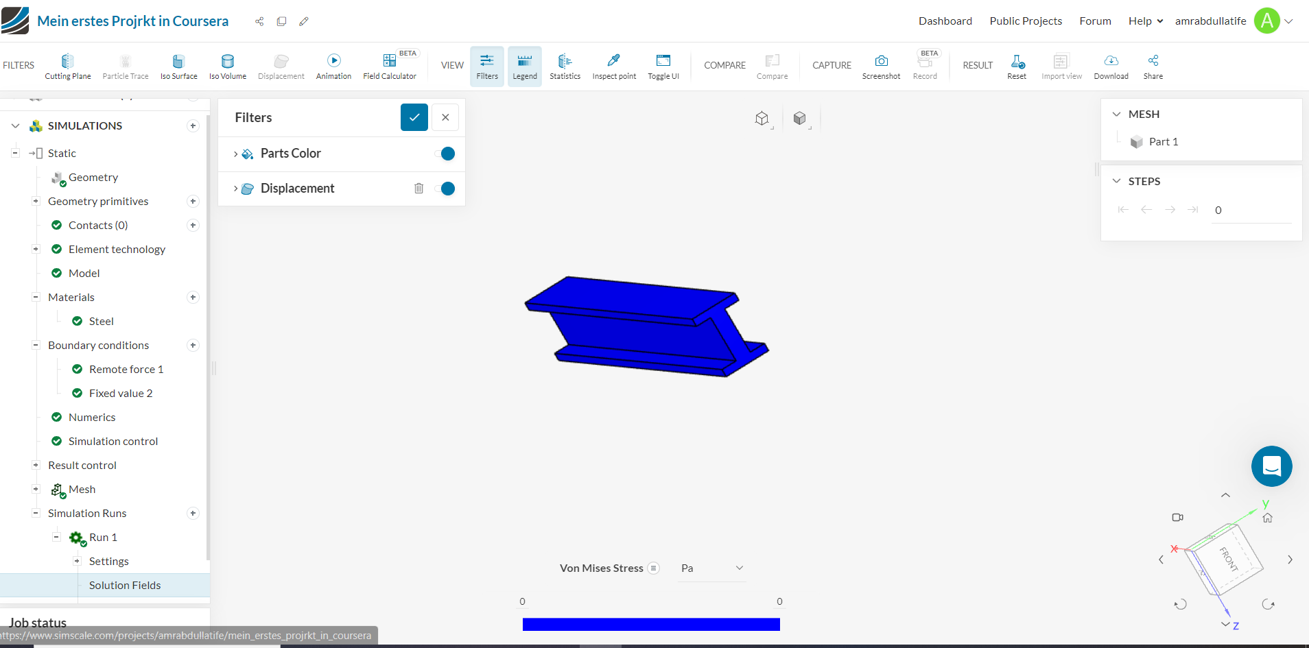

can you share the link to your project so that we can have a look at it?
Based on your image, the lower and upper limit of the legend is set to 0.
Please try to adjust the upper limit of the legend as explained here:
