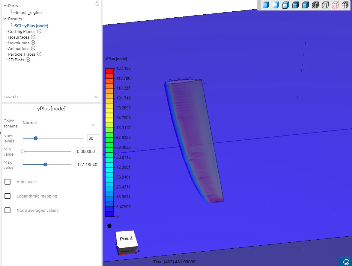

I can do this in the old but how to new post processor please?
I just want to see a yPlus surface mapping on my geometry but I can only find a way to do that by viewing trough translucent boundingBox faces and likely the internal mesh will interfere too:
Hey again Dale!
In the new post-processor it is not possible to perform such a task. We are working keen to include old post-processor features into the new one. It is good that you mention it though
Cheers and thanks for the feedback (in form of a question) again!
Darn, I REALLY like the new post processor but rarely use it, and therefore rarely evaluate it, because it does not have Save State, yet. Once that is there, lookout, I am sure I will have much more feedback
