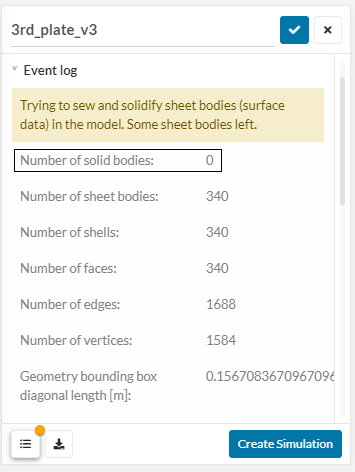

To run a Heat transfer simulation it is necessary to import a solid body model. However, your model consists of sheet bodies and no solid body, as you can see below:
I created a new version of your simulation using a solid body, as you can see in this link:
It should do the trick.
