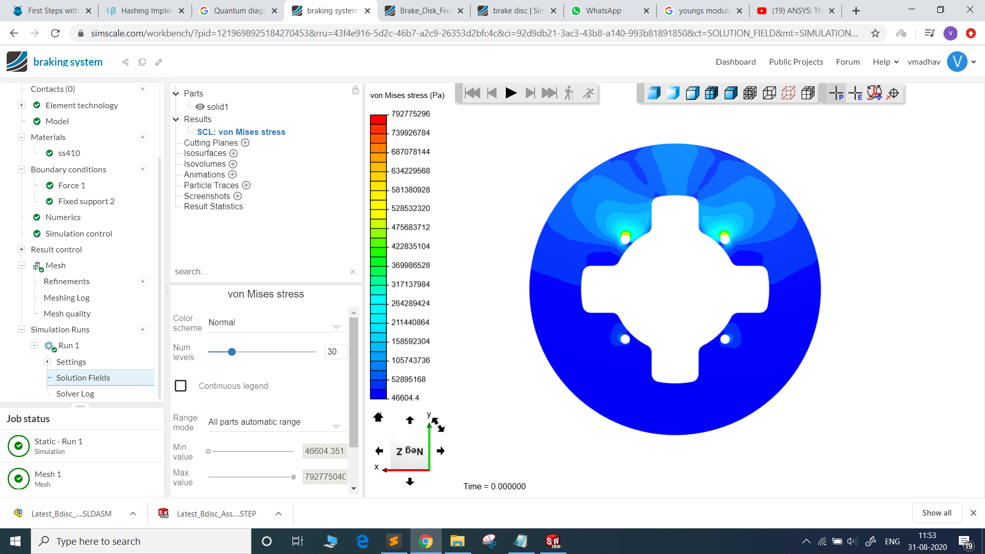

I was trying to do the static analysis of our Student Formula car,
But I was unable to set the safety factor and know the fatigue of the same,
I could’nt find the option for the same ,can anyone help in this regard?

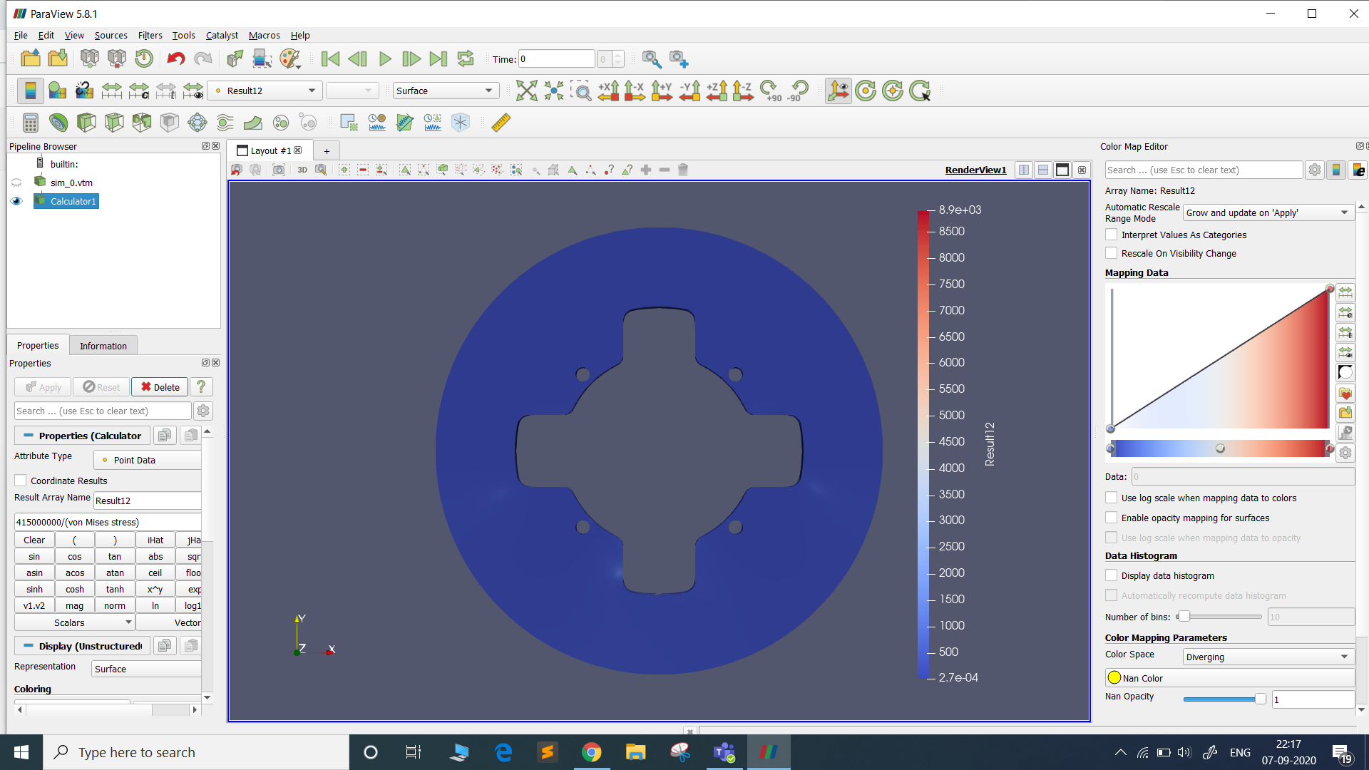

How you can do that in Paraview \rightarrow Use the calculator filter and divide the yield stress by the von Mises stress. @power_users, for alternatives, please add your two cents here!

hey @jousefm I have followed your instructions as you said ,but I am getting a huge mistake in the result.
See how the range of values are not in the 10s range. Is there any problem in the software?

Hi @vmadhav!
Which units are you using? Also if you calculate it that way everything below 1 would be considered a critical area.
