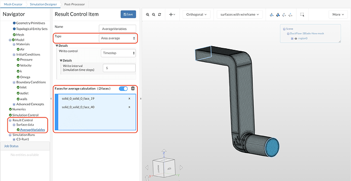

Hi @untilican3!
In the Result Control items you can add Surface Data - Area Average and then select the two faces you want to post-process the pressure difference with. That should do the job!
Example:
Project: Ventilation Duct Flow Optimization -HPAC Webinar by jousefm | SimScale
All the best!
