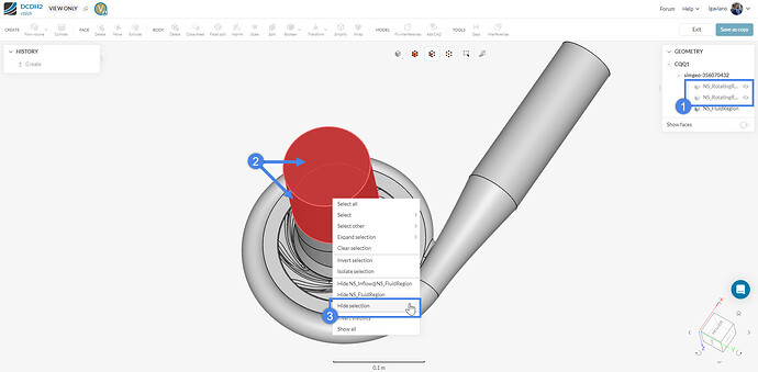

Hi @vtsich,
You can start by hiding the other parts of your model (1), then select the outer faces of this cylinder (2) and hide selection (3):

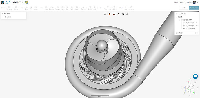

Then, you should be able to see the sphere and the walls to apply boundary conditions:

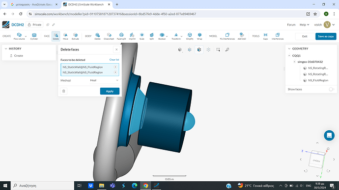

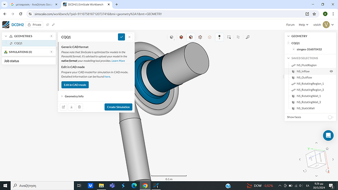

My problem is that i can’t select the ball to put it on a spinning wall. How do I set it up in edit CAD as a separate person?
I want to appear
Can I do it with this step?
In order to I add it in the simgeo

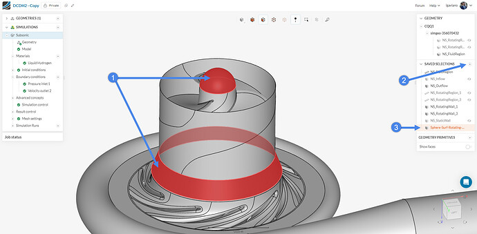

Hi @vtsich,
You can hide the outer faces as I’ve mentioned before then select the ones you wish to (1), create a saved selection (2) and it should appear on (3):

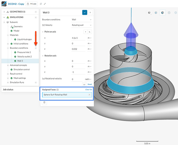

To assign the rotating wall, you should create a boundary condition and set it to the saved selection you’ve created:
Thank you very much!
