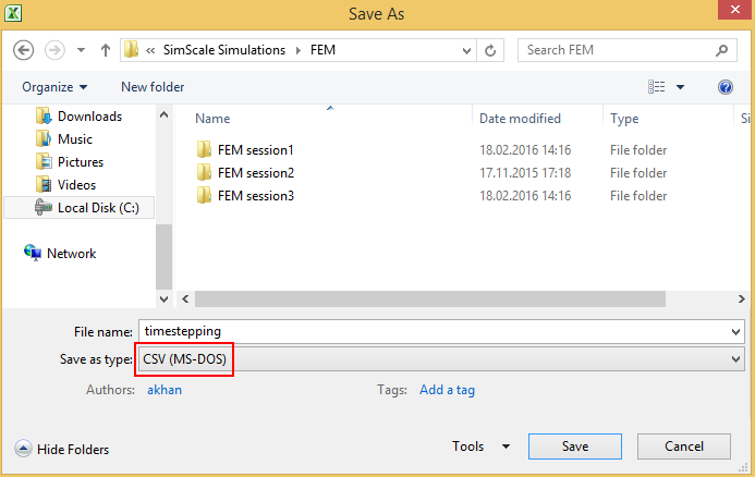

Once you are done with defining your time stepping scheme, save the file as CSV (MS-DOS). The figure below shows the selected file format in a red box while saving. Than click OK on all followed up warnings. MS Excel by default stores the CSV file with comma delimiter field. This Save as type is for MS Excel only, please follow the format based on your excel sheet software e.g. Libre calc etc.
Give the appropriate name to the file. This step will save the file in .csv format which you can directly upload. For testing it before upload, you can right click the file and open it with Notepad which should show you the file with comma delimiters as shown in the figure below.
