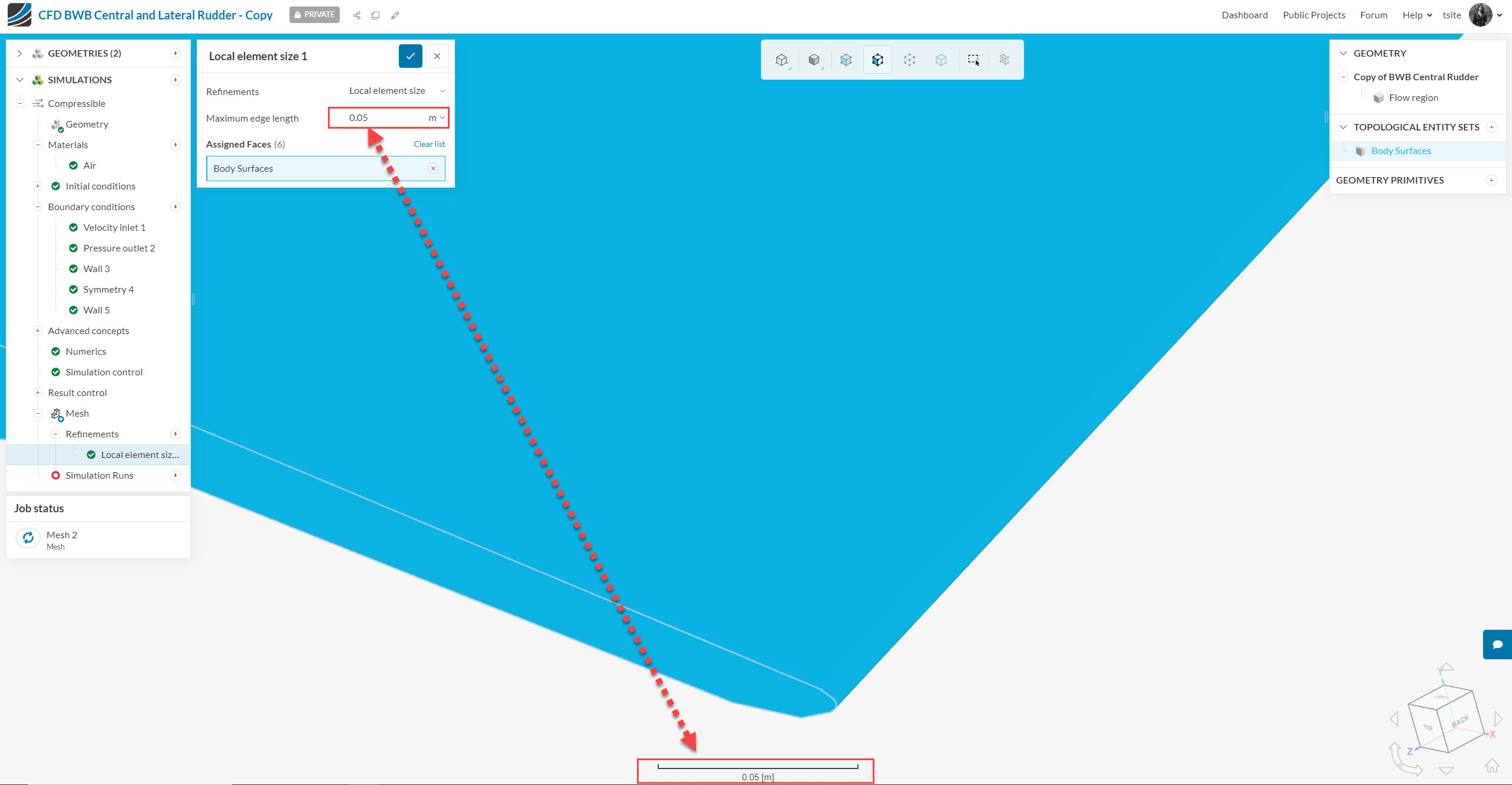

High non-Orthogonality at meshing airplane
My advice here would be to improve the refinements. For example, look how big the maximum element size is compared to the characteristics of the trailing edge:
What you can do here is to create a cartesian box that contains the problematic area, and add a region refinement with a very small “maximum edge length”, so the mesh is created properly. Go smaller than 0.05 on this trailing edge, otherwise it will not really help :slight_smile:
Have a look at the different refinement options here:
