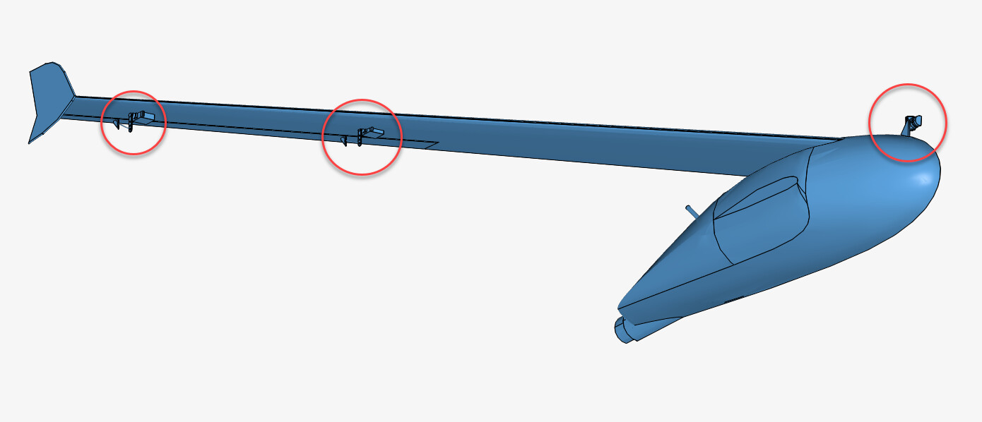

Here is the project link so you can take a look
I think that these features with small details are causing the mesh to be big:
You can simplify your model and try to mesh again.
Also, we always recommend to use the Standard mesh, at least you have a reason to stick the the Hex mesher.
Should I simplify these by adding blocks onto of them to simulate the drag they would preduce?
I would remove smaller details such as holes and thin wires.
