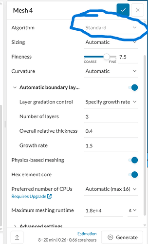

I have made a case in the solver Conjugate Heat Transfer v2.0. I want to make a mesh with hex-dominant algorithm but I can’t change it:
Is there any solution?

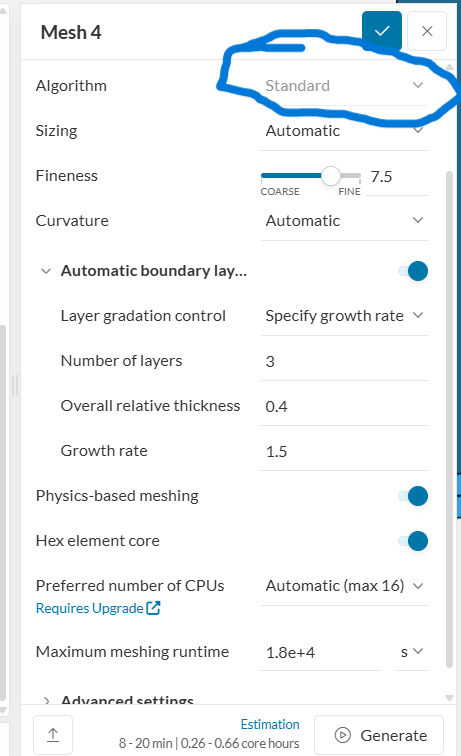

The conjugate heat transfer v2.0 solver requires a conformal mesh, which is not possible to obtain with the existing hex-dominant meshing tools, thus only Standard can be used.
