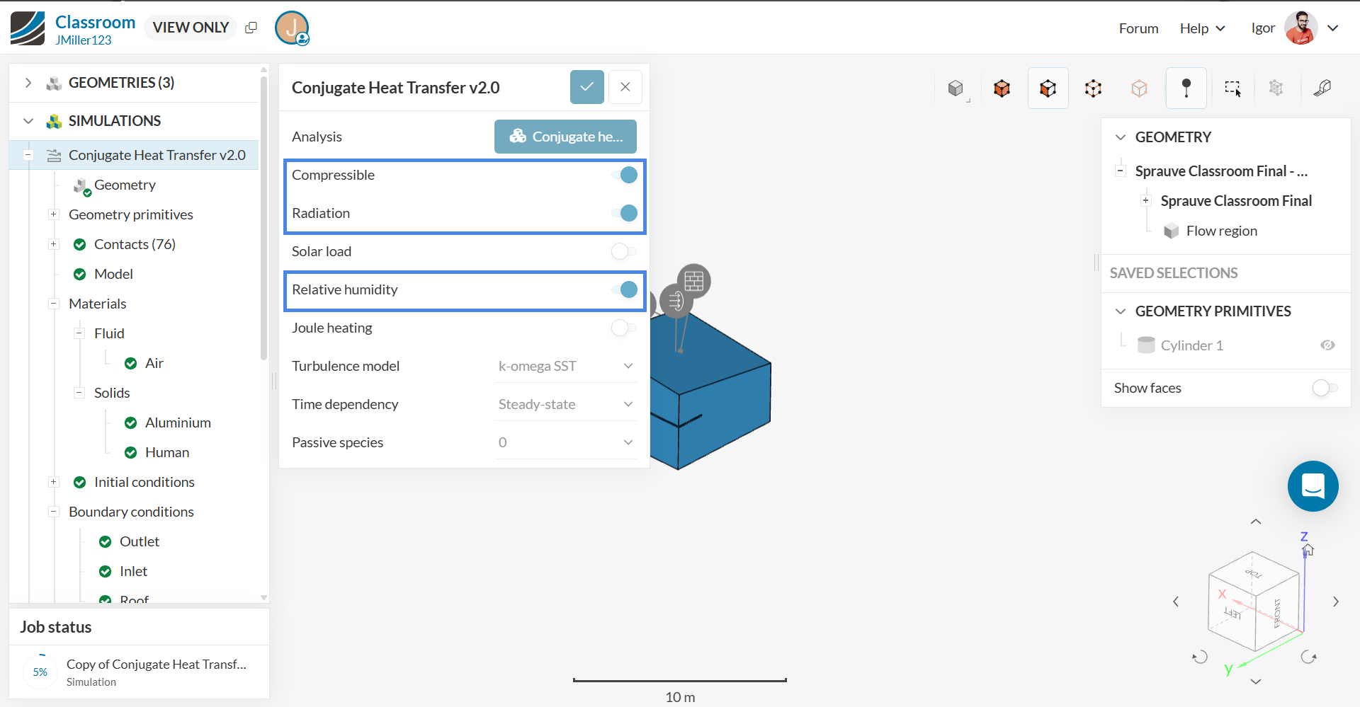

It’s tough to spot where the problem exactly is since your simulation has many additional complexities in the setup, namely:
The first advice I’d give you would be to do a first analysis with all of these global settings disabled and get that run converged before moving forward to more complex scenarios. Also, is there a specific reason why you feel it necessary to enable the “Compressible” toggle? I don’t see large temperature deltas on your simulation to justify enabling it (keep in mind natural convection effects are still modelled even with this option disabled).
As a last pointer, keep in mind that, if a wall is not assigned a particular boundary condition, it will be set automatically as a no-slip adiabatic wall.
Thank you, I will give that a shot and start turning things off to narrow down the issue. I have the compressible model on because one of the key metrics I would like to monitor is the humidity levels in the room to check for the possibility of condensation. I think it would not let me have humidity without compressible.
You’re correct, apologies for overlooking this. At any rate, please try running the sim w/o these options then build on complexity as you go.
