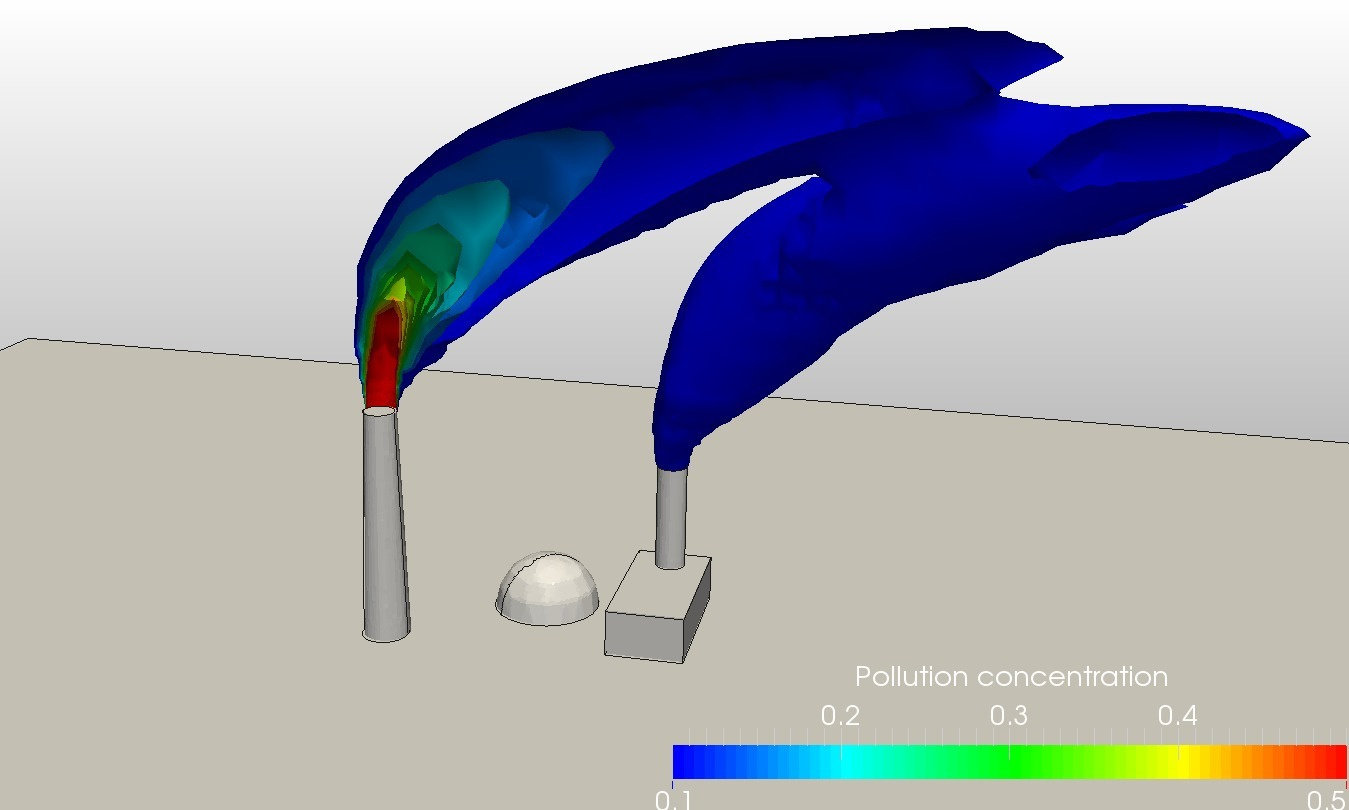

i am working on project titled (Pollution of Air through Exhaust Gases from a Chimney) based on editorial demo. i would be really thankful if anyone can help me to obtain below image. i believe the below image is obtained from paraview. however i am not sure how to obtain the below image. i would really appreciate your efforts for helping me on this.
thankyou,
Sam.

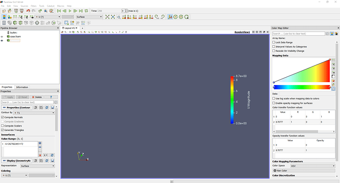

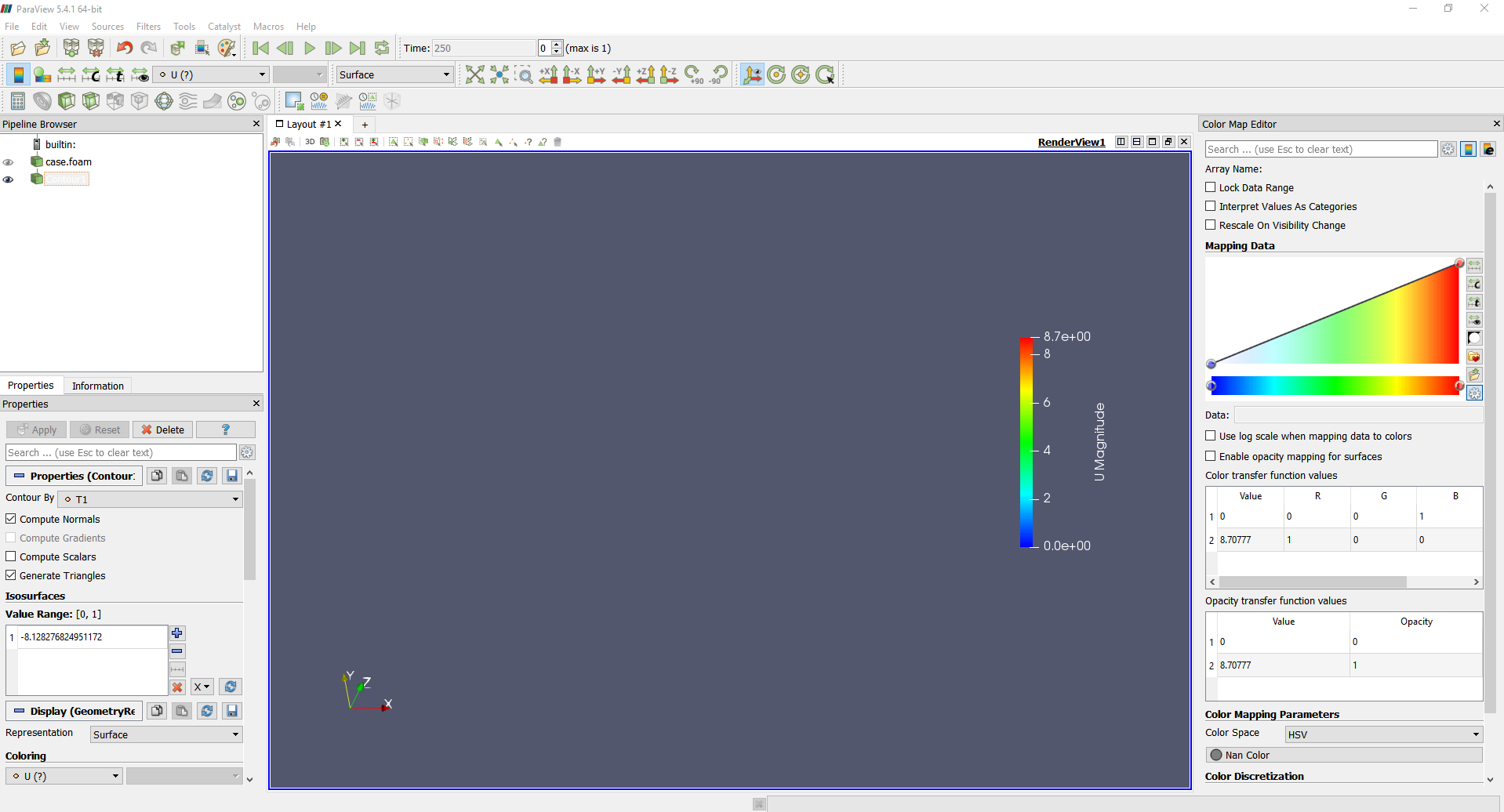

i am very happy with your instant response and for your efforts in creating the video. this video really helped me to work on the same file which i downloaded and performed similar operations in paraview. however when i am using the same approach for the following project ( https://www.simscale.com/workbench/?pid=1794688880864976650&mi=run%3A5%2Csimulation%3A1&mt=SIMULATION_RUN)
i am getting an error. i am pasting the image below for your reference.

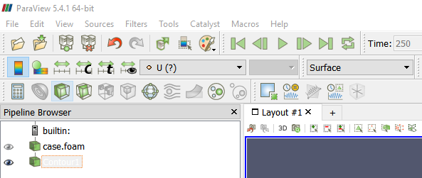

in the above image, it can be seen that U (?) can be seen. i am attaching separate image for better understanding.
i am using paraview 5.4.1 64-bit version. please help me to solve this issue. looking forward to hear from you. thankyou,
Sam.

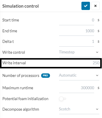

One easy way to save some space is by writing data sets less often (especially when meshes are this big).
With these settings, you will save 5 data sets in total (0; 250; 500; 750; 1000). By setting write interval = End time, your results file won’t be as heavy (0 and 1000 iterations data sets). This also helps with ParaView, as it will have less data to load :+1:
