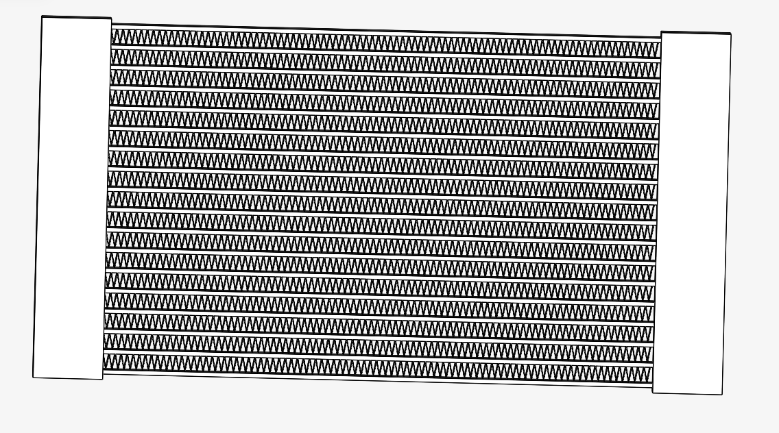

So, I’m trying to simulate our heat exchanger using the conjugate heat transfer method. But when i generate the mesh I lose the option to assign properties both physical and boundary conditions) to my geometry, it happens when a message apears asking to use the mesh as the domain. What am I doing wrong?

Hi Dale, here’s the project link. What is happening is, after I choose to use the mesh as the domain, my heat exchanger disappears. Thank you for your attention.

The radiator fins have a thickness of around 1e-4m and the current mesh setting cannot capture these features. Thus what you are getting is a mesh of extremely poor quality.
If you want to simulate this problem you need to have 3 solid bodies
a) Body1- It will be assigned as air and it will contain the other 2 bodies. You will give the velocity inlet and pressure outlet condition on this body.
b) Body-2, Aluminium fins
c) Body-3, the fluid that will pass through your radiator.
You have to first work upon your geometry before you start with the conjugate heat transfer analysis.

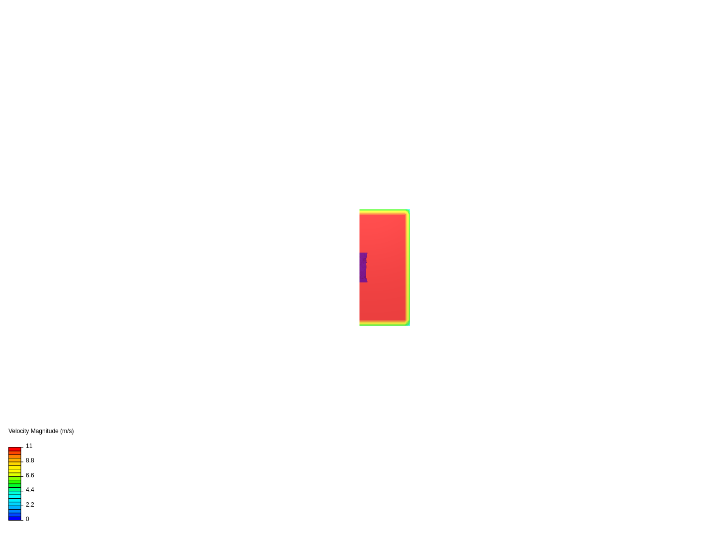

I am attaching a project for your reference - https://www.simscale.com/workbench/?pid=4584765497003201904&mi=spec%3A9cb938aa-4d22-470b-ae06-8c51b0914089%2Cservice%3ASIMULATION%2Cstrategy%3A35
