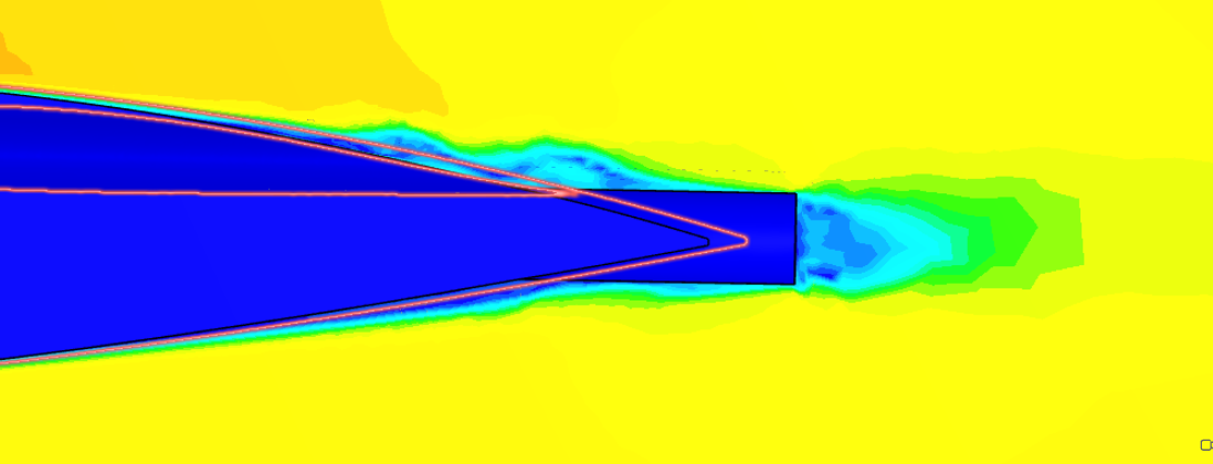

accurately y+ under 1(fingers crossed), the y+ is under 1 but there is this giant weird flow separation right here -

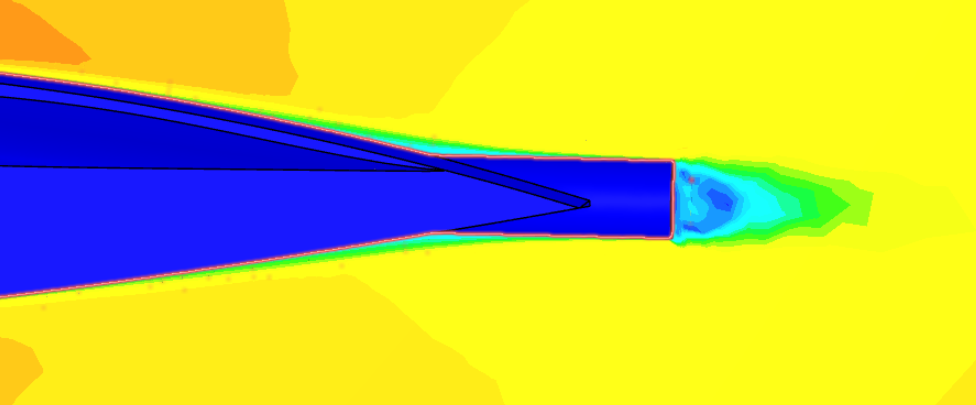

here is what I think its suppose to look like -
I don’t know what this is happening, perhaps you have an idea?

my guess would be that the k-w-SST solver, which we use, is mostly designed to solve all Y+. This can result in some inaccuracy for extreme Y+ areas and Y+ values for the buffer layer ( 3 < Y+ <30). Due to that fact, such inaccuracy can occur. That’s why you will always have to do the mesh sensitivity analysis and physical validation. In best cases you can do physicaltesting and apply this information on the selection of your turbulence model.
If the data you get to not have a big difference ( Drag/Lift Coeffiecent) I wouldn’t be too concerned. But for sure that would be an area of interest when doing physical testing.

hello, I reduced the inflation layers to ten so that the y+ would be 1 and it worked and it stabilized and the whole thing looks good, I think it was because there was a missing inflation layer when I did 15
frank lucci
Yes this can happen if the aspect ratio in the inflation layers gets too small. With that, a bigger layer would be needed.
But I guess you are good with the 10 layers.
