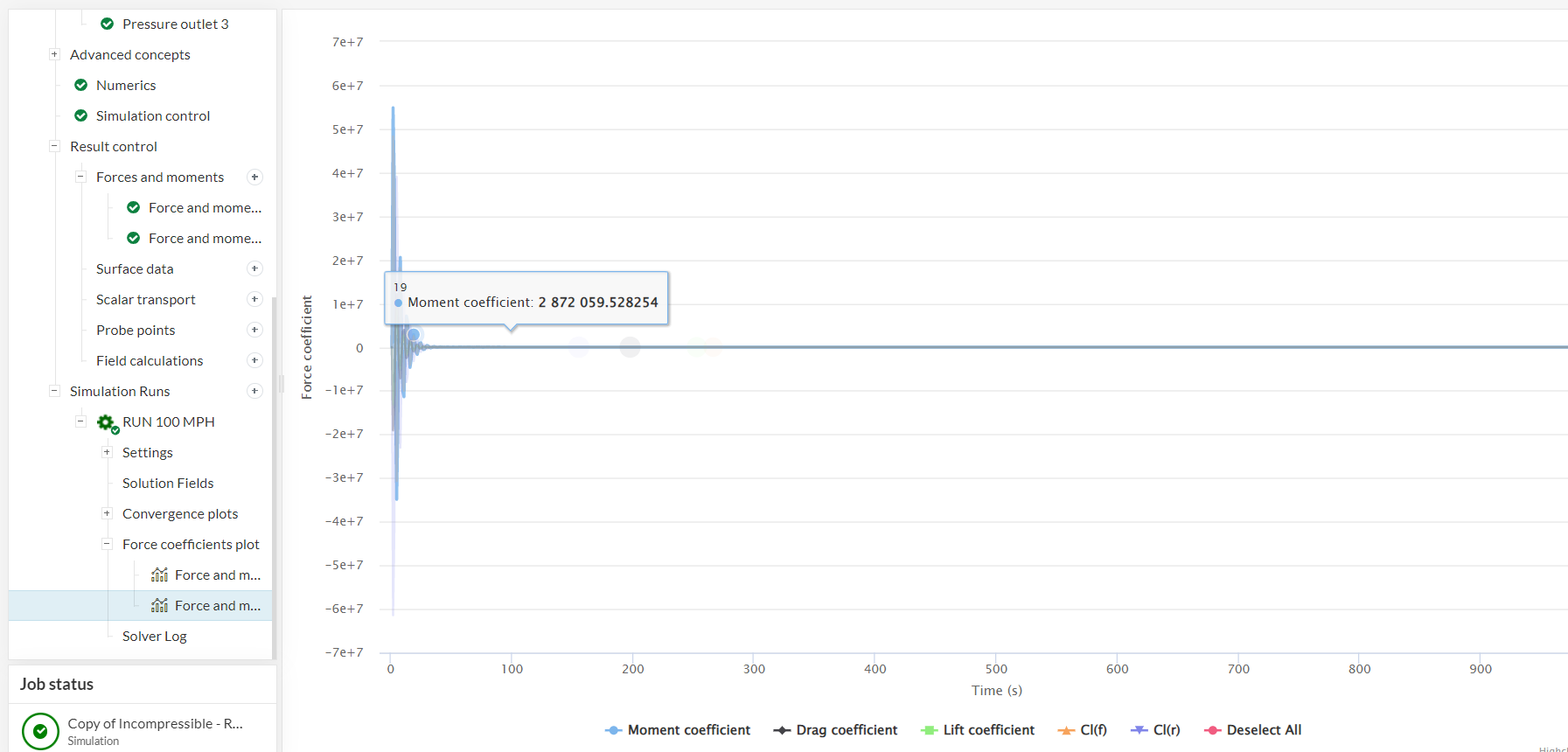

Second, I am curious how to get accurate numbers for the forces. I don’t exactly know if what I’m seeing is correct or how to read the data at all but I would like to know.
Additionally, can someone please inform me if any of the numbers I have for any of the testing actually make sense. I am not confident that I did the testing totally correctly and this would be amazing if I could get some feedback. Thanks so much!

I am unfortunately away from my PC now, but here is an article I would suggest going through to check if the Force and moment coefficient setup is correct. Why Are My Lift And Drag Coefficients Too Big/Small? | SimScale
I would check the drag and lift directions according to your model to get correct values. I can check your setup by tomorrow morning and give additional pointers if its ok.
