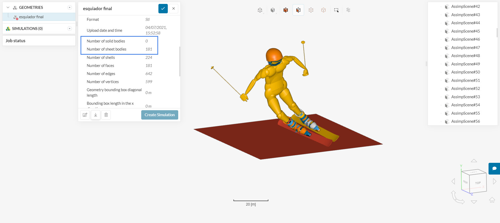

Very complex stl geometries can be a little tricky for the OpenFOAM solvers, because the stl file needs to be fully solid (i.e. a closed polysurface, watertight geometry). The current model has a handful of self intersections, and consists exclusively of sheet parts (so the geometry is completely not watertight):
Fixing stls is actually quite challenging - the task is easier to be done with the software that was used to design it AND by the person who designed it. This page might give you some more insights.
