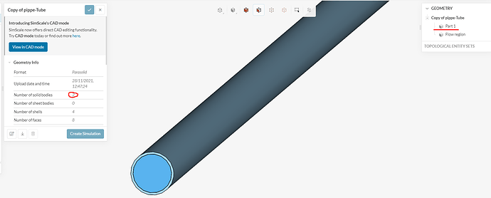

Problem: I cannot generate the mesh and run the simulation. There is no log, just the announcement
A setup with 2 regions is being used in a single-region analysis type. Please make sure that all regions except for one have an Advanced Concept assigned to them.

Hi yapabox589 great that you reached out to us in the forum.
please be sure that your simulation only consist of one solid volume, in this case the flow region.
You can delete the part_1 (pipe) within the CAD Tool.
Also Set the outlet boundary condition to 0Pa. Without any pressure there will not be any flow.
