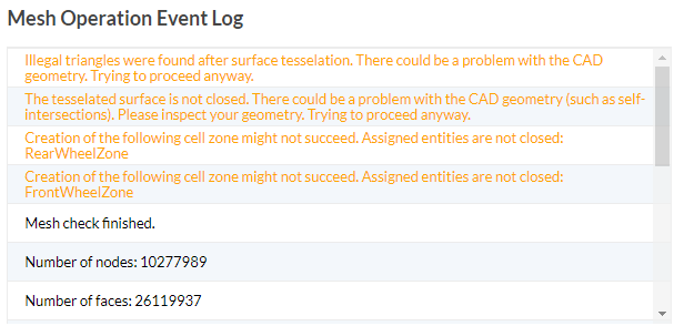

I’m currently on the 4th assignment for the Formula Student Course. I have a problem meshing the car, the mesh operation event log says it’s due to RadiatorZone and FrontWheelZone because they are not closed.
I know all component’s should be closed to run a successful mesh operation, but the geometry is provided by simscale themselves. So if anyone have had the same problem with the 4th session of Formula Student project or anyone would give it a look i would appreciate it.

Just shared my mesh with you - should have received an email.
Hi @jousefm

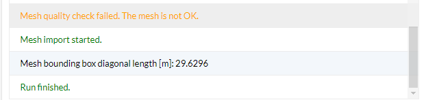

Thanks for helping, i see your mesh has completed. But the Event log still shows some error’s, wouldn’t this effect the simulation if the mesh doesn’t pass the quality check.
Hi @SNielsen!
That’s a valid objection and indeed we need to improve the mesh a bit more as we still have over 300 illegal cells. @Get_Barried,did you already perform a meshing operation?

I have completed the mesh, i lowered the meshrefinement for the frontwing, it might have been to complex. I will just run the simulation. The 2th session which i have to compare with has the same errors. Thanks for the help.
