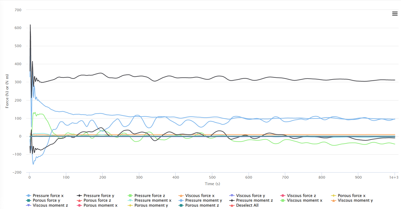

My project is to find the sources of aerodynamic drag of an automotive trailer, and improve its efficiency. I would like to do CFD simulations of different models (each model has some kind of improvement), and later on compare the results, to find the most efficient solution.
I have run into several problems, that I have had solved with other forum posts, but now I cant get my head around plot deviation problem. As seen on the force plot below, the forces and moments are not diverging, instead they are very swirly. I have changed some settings, simplyfied the model, enlarged the flow volume and so on. My model is 3 times smaller than the actual thing, but to get the forces correct I increased the air density 3 times.
The latest is Run 12
What changes should I make, to get the right aerodynamic drag force for my model?
