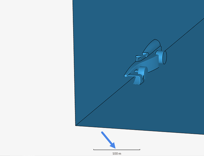

I am working on an f1 in schools car and have the same problem but do not know how to fix it. could you tell me how you did it?
all the best,
George
Assuming that you have created at least a forces and moments result control, you can manually calculate Cd and Cl with the formulae outlined here: Why Are My Lift And Drag Coefficients Too Big/Small? | SimScale
I mean my values are in the millions. So I do not believe that my values are correct and it is the result of a flawed car. do you have any other solutions? Because I really do not believe that the values are correct
thanks in advance
George
It looks like your model is wrongly scaled.
OMG thank you very much I never noticed that before! thank you very much for your support!
