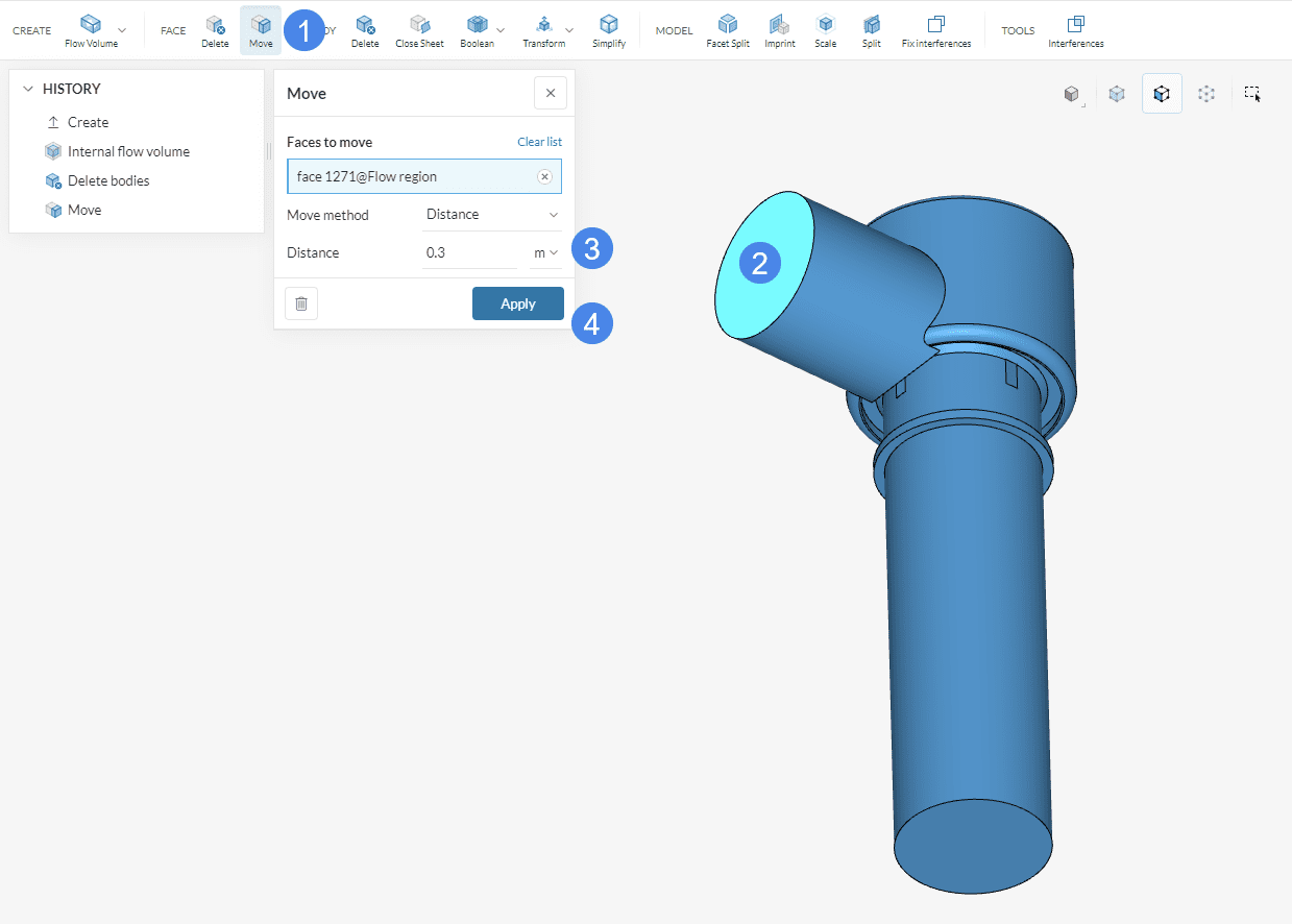

Thank you very much for sharing this! It seems an inconsistency from the tutorial about the fluid domain. It looks like 0.2 for the inlet and 0.3 for the outlet are not enough to the fully developed fluid condition that we need to have for this type of case.
Please regarding those values, please consider
0.3 for the inlet and
0.4 for the outlet and then let me know how simulation goes with those new values.

I tried 0.3 and 0.4 and then 0.4 and 0.5. Still no luck.

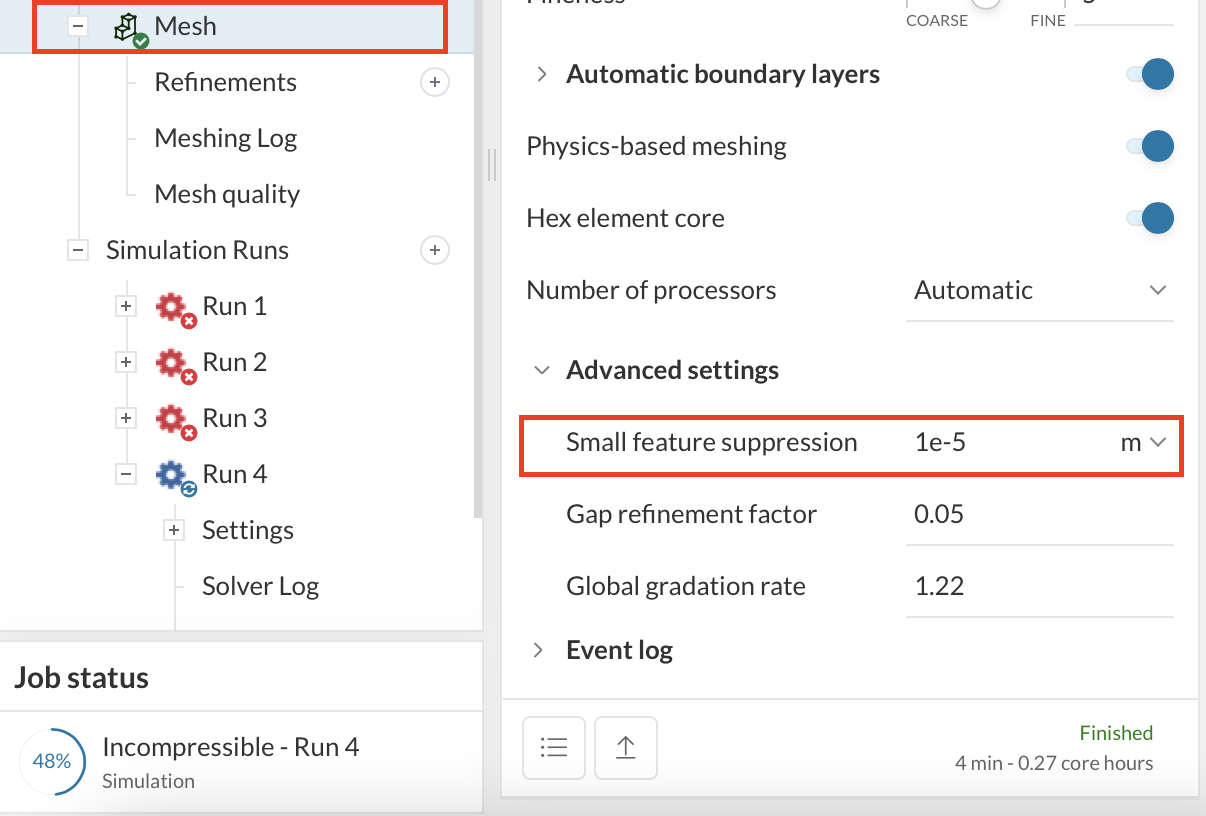

That’s quite interesting once I have did it with 0.3 and 0.4 and then ran perfectly. Anyways, already putting an eye on it with the team and they also suggested to put small feature suppression in 1e-5 in the mesh parameters. Once you change it, for sure it will be running well
So sorry for that once it is an introductory tutorial and must not be dealing with this kind of issue. Otherwise, thank you very much once again for sharing this with us, it help us to be better and we will work to fix this tutorial page with the right new values.

Whew, that did it. Thank you for all of your help while I get up to speed with this awesome software.
